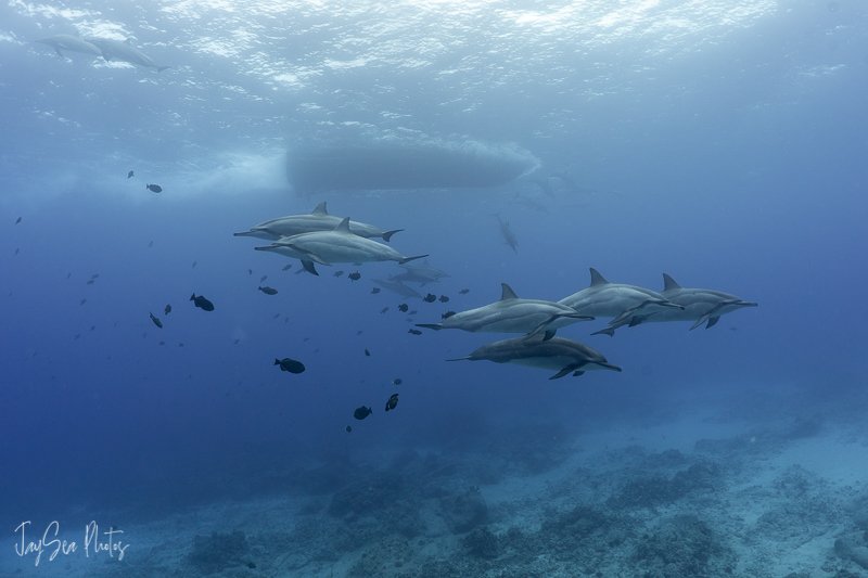

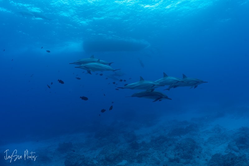

  5. Here's an export of the RAW file before and after correcting.  Is the original too underexposed?
  6. A couple of questions, how far are you from the dolphins and how deep?  There is not much red light in the histogram for this shot, you've basically managed to balance the dolphins but in the process suck the life out of the water.  How did you WB this one?
    It looks like you are shooting into the light with this shot as well, it would probably balance better with the sun behind you?  I don't think setting the WB UW would change things very much on this shot.  A red or a magic filter might help more by blocking some of the blue/green light.  I would still try doing a custom WB at the same depth when you are next out - it certainly won't hurt.
  7. I am fairly close to the dolphins ~15'.  Lens is 28-60mm @60mm with WWL-1B.  30-40' deep.

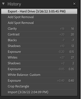

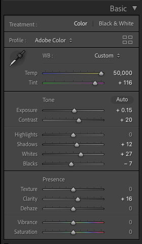

    I white balanced this in Lightroom.  Started with the eye-dropper on the dolphin's white belly, then fine tuned with sliders.

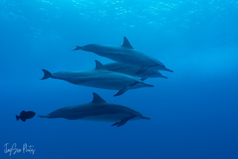

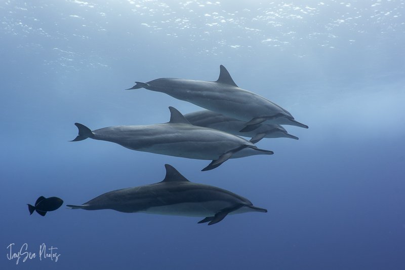

  8. Here is another shot (before/after processing) on the same dive with the sun behind me at approximately the same depth, but further away from the dolphins.
  9. It looks like it has clocked out on correction to maximum on colour temperature.  As I recall you are shooting with Sony A7C, Sony used to have a reputation for not White balancing so well, but believe they have improved recently. Other camera makes have a reputation for doing WB better, but I'm not sure it would make a huge difference.
    I think your issue is mostly down to the fact that the dolphins are blue as is the water and if you correct one you also shift the other - so it sucks all of the blue out of the image.  Your second image does look better but if it were me I would back off a bit towards the original and stop where it seems the water colour is about right.  I think the water really needs to appear a nice blue.  I could post a smaple if you like?
