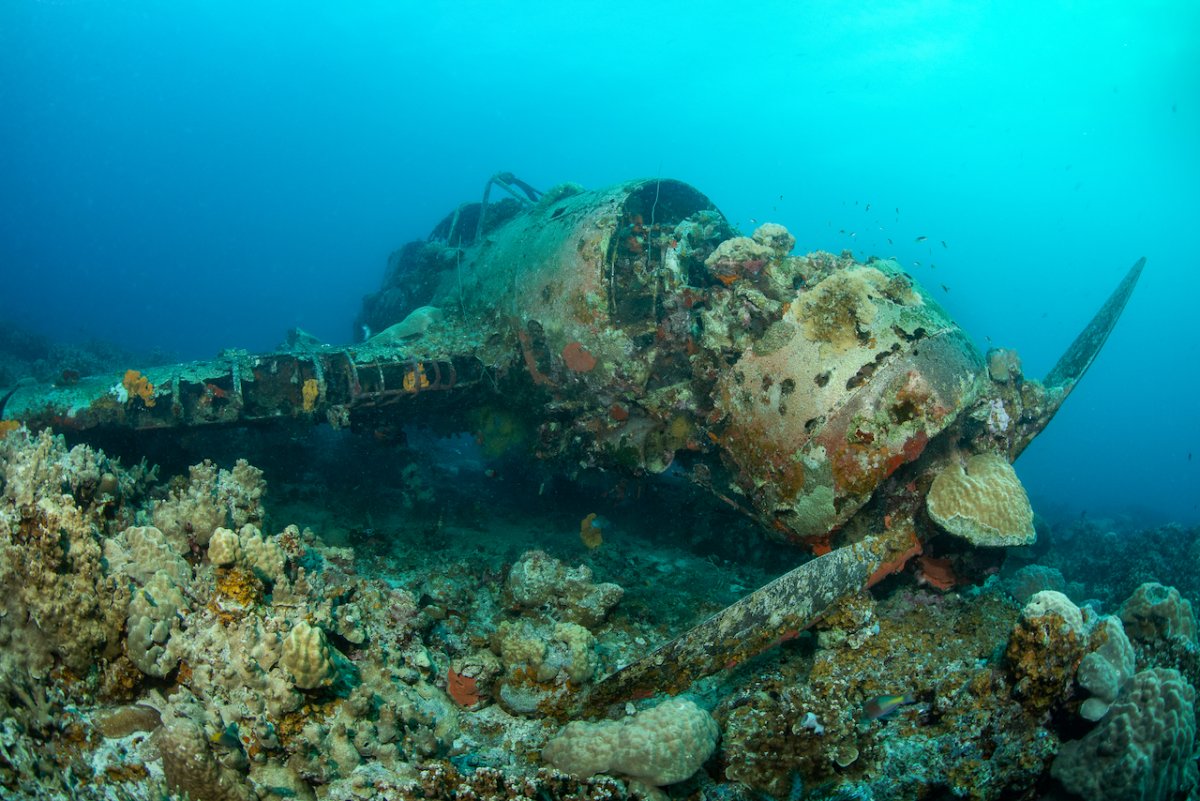

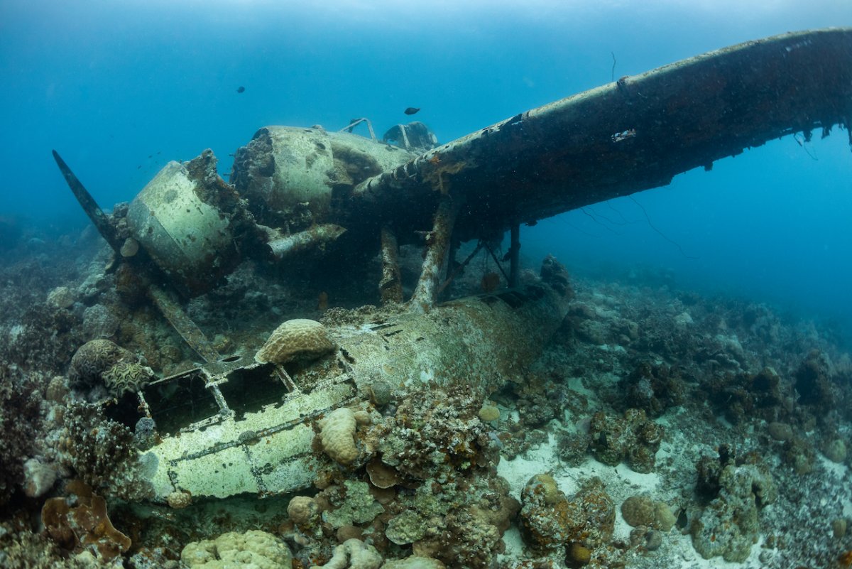

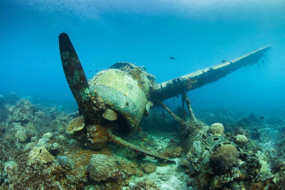

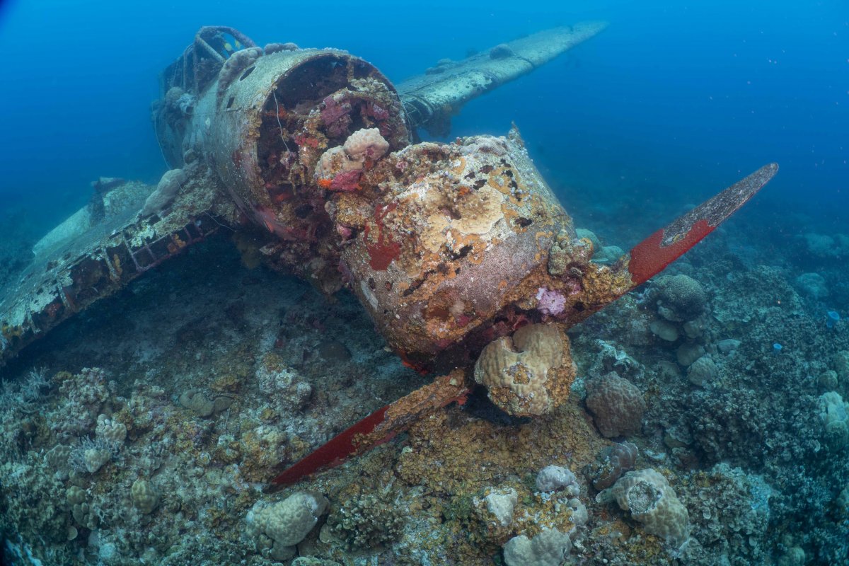

  12. I guess it depends on how critical you are and what you will do with your photos.
    I shot these with my Canon 5Dmk4 and the 8-15 with a 140mm dome. F-stops were 9, 6.3, 10, 7.1 (in that order). The corners are sharp enough for me. The visibility was about 40' for the Palau Jake Plane and only about 25' for the Galapagos hammerhead, so the shots aren't great, but ok based on the conditions. I used a Tenko 1.4 TC for the Galapagos shot.
    Edited by JohnnyQuest
