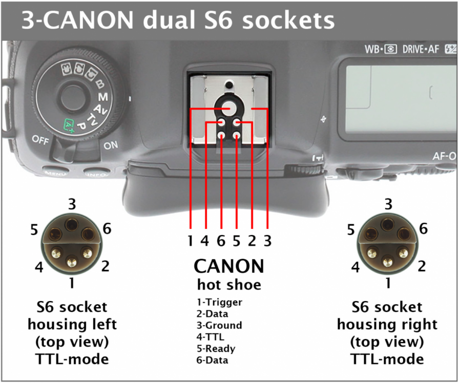

    The ONEUW strobes have all the TTL circuitry for Canon or Nikon (there is a version of the strobe for each). There is a little confusion around how to rig a pair of ONEUW strobes to a single passive bulkhead (i.e., no flash trigger, just straight-wired from the Y cable). Here is what you need, confirmed by both Reef Photo and ONEUW in Italy. This will enable you to use the strobes in either TTL or manual mode.
    I have attached screen captures of the ONEUW wiring diagram and the product page for the correct Y cable. Reef can supply both of these things, but the cable is a new product, so it may take a little time to get them from Italy.
