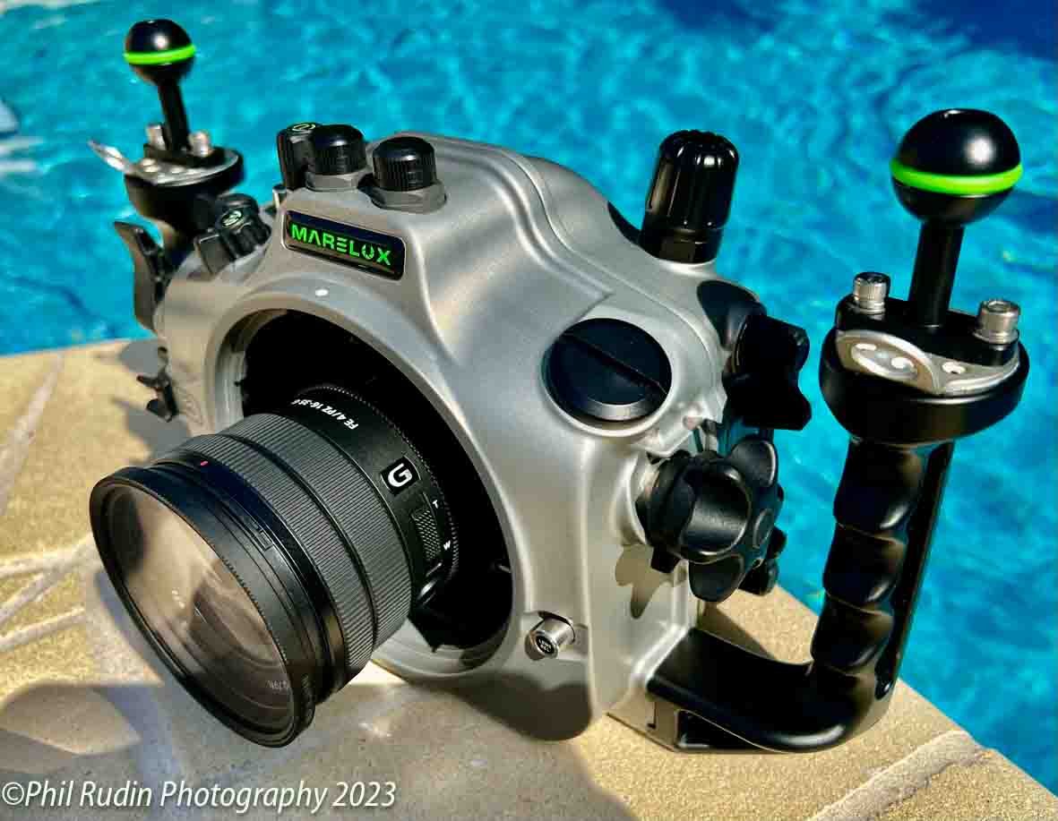

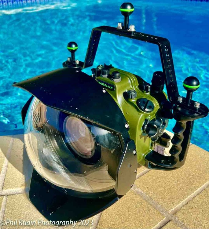

    Three un-cropped images of Roman, the split is at 16mm shot at F/4, with sunglasses 35mm at F/11 and the vertical is 16mm at F/11. These are taken with the Sony A-1 in a Marelux housing with the recommended 50 mm's of extension and a 230mm dome port. I was also using the S&S 77mm lens with a 72 to 77mm step-up ring. You can see the S&S mounted on the PZ lens in the silver Marelux MX-A74 and with the 230mm port on the green A-1 housing.
    I also used the lens with the 305mm (12 inch) Matty Smith port and I would be hard pressed to see much of a gain in IQ however it helps in other ways when shooting the splits for which it was intended.
