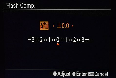

    Shooting TTL with UWT Converter, better adjust (+/-)Flash Exposure Compensation by camera menu scale, it gives much more adequate and wide effect than Z330 right dial for this aim. You will see it on practice. I advice to keep the strobe right dial at zero correction ("12 o'clock" position) and use only camera controls for adjustment. This case you will clearly understand the Flash Exp Compensation effect. Using this concrete conception and synchronizing by fiber optics, you can keep Z330 magnet Up or Down, no difference for shooting.

    It clearly is faster to adjust the flash compensation via the camera in one step unless you need one flash to put out less power than the other.
