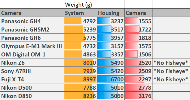

  16. So I have been quiet as been digging and creating pretty spreadsheet things. For now these are based on Nauticam parts (which is perhaps not the best choice if one considers their general prices and their recent price "improvement" of popular camera housings). But, I am currently using their system (I am waiting for that N85 converter Aquatica ;) ), so can compare actual lenses/ports I own and I am familiar with.
    Another factor is technical data - all companies slack here, Nauticam is no exception. So finding data like weight becomes a real challenge, which took me way longer than expected. So sadly while I was planning to add Aquatica et all, it is not there now, perhaps at some point in the future if i have the time...
    And other manufacturers will make difference, both in weight (for example GH5/GH5 from Aquatica is only 2450g, while Nauticam GH5 is 2360 but jumping to a whooping 2800 for GH6.
    Similarly expect big jumps in prices - again Nauticam GH5/GH6 is about 4500 USD (funnily enough GH6 being cheaper), meanwhile Aquatica 2950 USD and that includes vacuum thingie and flash trigger - another 600+ USD if going with Nauticam). Also in general things like extension/adapters/ports etc will be even 2x+ cheaper than Nauticam - in other words, total system price might be 1000s less if going with others.
    Also note that i have excluded things like zoom gears/strobe triggers etc for now as these do not add much to the weight. However as these do add to the cost, you could take number of lenses and multiply by average price of 300 USD then add another 300 for a trigger so say 4x 300 + 300 - add about 1500 USD to the total price (though not everywhere as for example Nikon Z6/Z7 housing has trigger built in)
    Not included is also Canon FF system (no real entry level camera) as well as Panasonic S5, as there are no housings yet and no real data on underwater performance.
    As for the spreadsheet i might make it available here, if there is any interest, but for now i want to clean it up a bit and see if some things can be automated to a degree. Though if you do feel like you just cannot live without it, do feel free to PM me.
    So here we go:
  17. 1) Comparison of macro/standard/WA/fisheye setup weight (grams):
    A few notes:
    -while this one is pretty accurate I had to estimate weight of some oddball extension ring that i could not find anywhere or OM1 housing (as its still TBA)
    -weight of fisheye lens/necessary housing parts is not there for Nikon/Sony/Fuji as these systems do not have a fisheye lens. Hence that will skew it a bit vs others.
    -in general I've tried to use least parts/share ports etc. however as i am not that familiar with lenses other than M4/3 some of my choices could be questionable :)
    -similarly i've tried to avoid any glass ports/wwl/wacp and other potatoes. That was however not possible with Fuji, as apart from having tiny choice of lens, most require glass parts.
    Thoughts:
    Olympus cameras and GH4 are undisputed winners here. GH5 and especially GH6 housing seems to have gotten fat. FF can be 1.5-2kg heavier, to the point of being even heavier than the dSLRs.

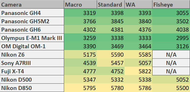

  18. 2) Comparison of system, housing (as in all parts needed to take macro/standard/WA/fisheye underwater, as well as camera body and lenses weight (grams)
    Notes:
    -zoom rings/strobe triggers etc, as well as any other parts like strobes/lights/arms and all the metal junk are not included
    -these are the same parts as used for weight estimate, so lens choice might or might not be questionable.
    -as noted previously FF systems do not have fisheye choice, as such their total weight is skewed
    Thoughts:
    -M4/3 is significantly lighter, up to 3kg. This however decreases slightly with GH5/GH6 due to their heavier housing. Surprisingly dSLRs can be lighter than FF setup, even including fisheye lens. Even the D850 aka "the brick" is very close, and in case vs Fuji (with glass parts) actually lighter
    - dSLRs system seem to in general be better "designed" - there is not only more lenses, but most can share ports and extension, while in FF there seems to be more "single use" extensions, or the need to use N100 o N120 adapter, adding more weight vs dSLR
    Edited by makar0n

    -D500 - as it is no longer appearing on Nauticam website i have used launch price of 3500 USD. That said D850 is currently 5159. A similar paradox occurred with GH5 - launch was 2650, but as Nauticam decided to "improve" that since, it is now 4540 USD. However as it is still listed on Nauticam website i have used the latter
    -as previously no fisheye for FF, hence cost is also skewed a bit vs other systems
    -it is entry level FF vs top of the line M43/dSLR
    Thoughts:
    -Not as much difference (vs M43) as one would think, that said I have avoided glass parts where possible, and those somehow will recommended when going FF/dSLR vs somehow optional with M4/3
    -as we are comparing Nauticam prices, their price "improvement" effort of the last year certainly shows - just see 1000s difference when looking at GH4 vs GH5/6. Others will be also affected to some degree, though probably lesser one.
    -interestingly dSLR win vs FF yet again, being actually cheaper than even entry level FF, even when FF has no fisheye lens/port/assorted garbage factored in
    -D500 seems to come out as the price to performance ratio king - great quality and price even lower than M43 setups

  20. 4) Closing points at least from my perspective:
    -weight - FF is not great to say the least - my general impression is this system is slightly less thought through/designed than dSLR (being its closest counterpart). Plenty of random  extensions/adapters and other weight adding crap. Also it somehow feels that a lot of these extensions are of almost single use only while in dSLR there seems to be less different ones and these are usable on more than one lens/port
    -cost - here FF is simply terrible, where even the entry level setups can costs thousand more than even dSLR ones, and that is even without the fisheye options. Also the gazillion of extensions at 600 USD a pop makes it even worse
    -complexity - another thing that has dawned on me - M43 is simple, take housing + port, done. dSLR/FF takes it to a whole new level, with a tonne of extension/adapters/adapters to an extension to an adapter and other nonsense, especially visible with Sony and the usual recipe "...take the N100 to N120 adapter". That is way more points of ingress and o-rings to worry about. Not to mention you get to spend even more time with your camera while the rest of the group has dinner or enjoys evening beers.
    -interchangeability - with M43 I can change bodies to different brands and keep the lenses. With FF and their mounts, I am mostly stuck within a given brand.
    -size - another issue in addition to the weight - smallest, non glass dome is 8.5", Lenses can also be up to 2x bigger. And you have to stuff it all to your backpack and then try to squeeze in that generous 7kg hand baggage weight allowance.
    -image quality - seems to me that while the entry level FF would have a better quality than M4/3, whether that difference would be significant enough to warrant big weight and and sizeable cost increase, seems debatable. For anything serious one would have to go with top of the line choices and then expect another 5000-8000 USD added cost, to the point of being 2x price of even D850.
    Edited by makar0n
