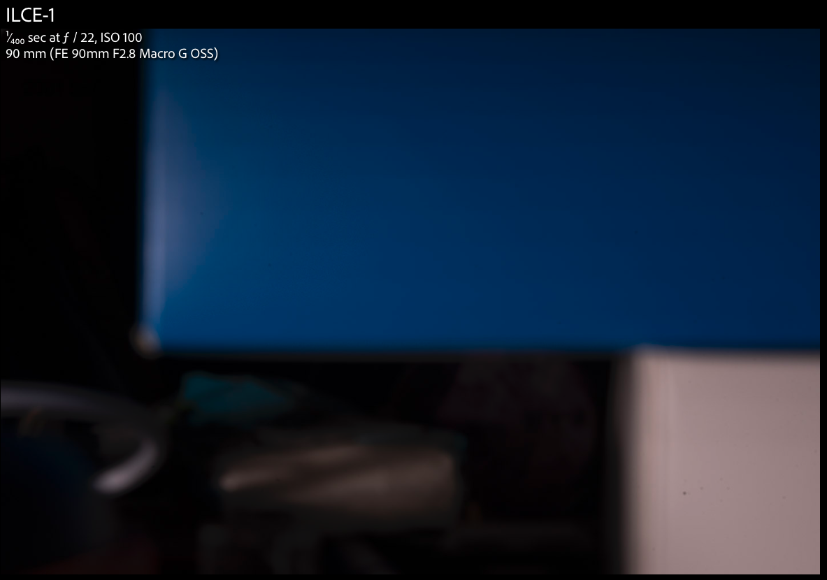

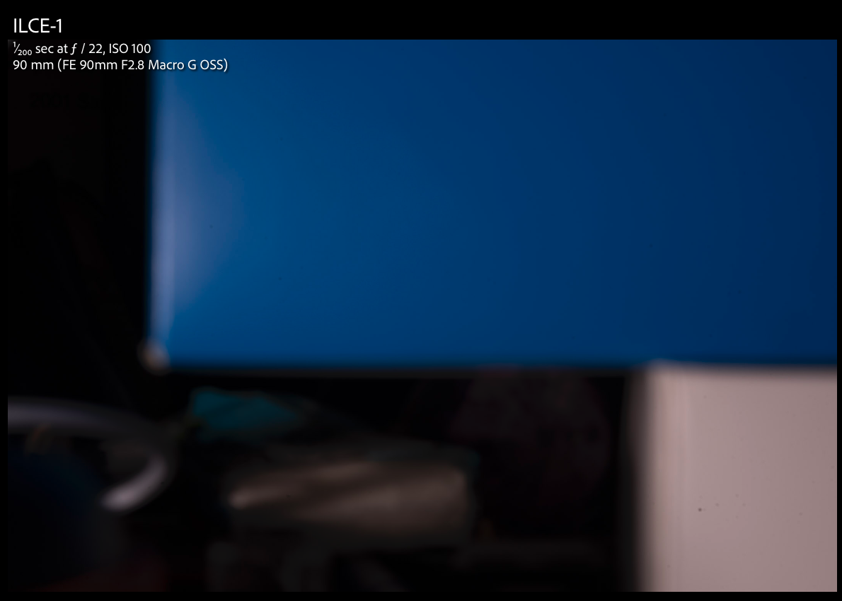

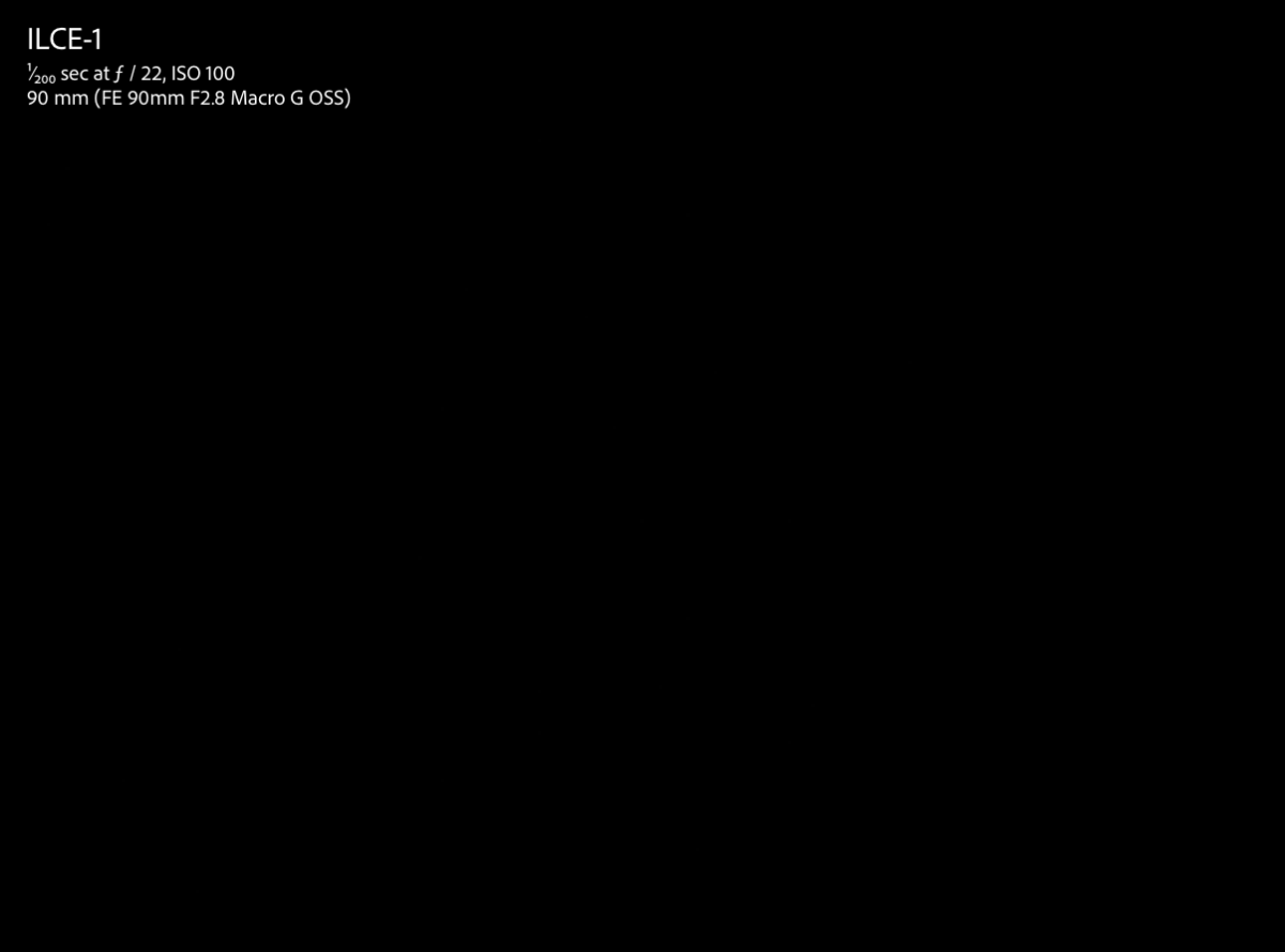

  10. @Oskar - I did as you suggested.  The three images below are screen grabs from Lightroom.  First has a single flash connected but turned off.  Second two it was turned on at full.  All three set to manual.  Clearly the flash is firing at both 1/200th and 1/400th.  As you suggested, the one taken at 1/200th is brighter than the one taken at 1/400th (by about 1 stop), which frankly doesn't make sense to me.  Is the difference due to a bit more ambient light coming in?  The flash should be way faster than 1/400th, so the flash impact on both the 2nd and 3rd images should be the same, no?

  11. 13 hours ago, Oskar@RetraUWT said:
    I am not sure about the sync speed of the Sony A1 but normally it’s about 1/200. Above this you need to use HSS.
    Sony A1 is a special case; it can sync at 1/400s normally, and 1/500s in APS-C crop mode.
    I really wish someone with access to an oscilloscope would measure the discharge curves of Retra strobes flashes. Refer to this thread:
    View archived post in: Flash duration?
    Since the Retras use a circular flash tube, it's quite possible that at full power, they emit at full intensity, or near enough as to make no matter, for 5ms or even longer - perhaps Oskar could enlighten us? When you're shooting at 1/400s, your exposure time is 2.5ms, and at 1/200s it's 5ms, so if the flash is emitting continuously during that period, a 1 stop difference between 1/200s and 1/400s makes perfect sense. For what it's worth, I shoot sunballs with an A6300 and a pair of Retra Pros, and I either use f/22 + 1/160s (my highest available normal sync speed) or f/8-f/11 and HSS at around 1/1000s.
  12. In manual mode everything looks normal. There is no ambient light on the images, the light on the 1/400 is less due to longer flash duration. The maximum power flash duration is about 4ms. This is more or less standard on any flashgun with a circular flash tube. With a linear flash tube we can usually get shorter times, about 1-2ms. It seems that with Sony A1 they allow the slightly higher sync speed only by using the later.

  14. 1/400 sec shutter speed is 2.5 msec and the flash duration at full power reported to be 4 msec.  This means that 1/400 sec the maximum power available at 1/400 is 60% of full power .   You need to shoot at 1/250 to get the full pulse length and full power reducing the benefit of the 1/400 flash sync with this combination.
