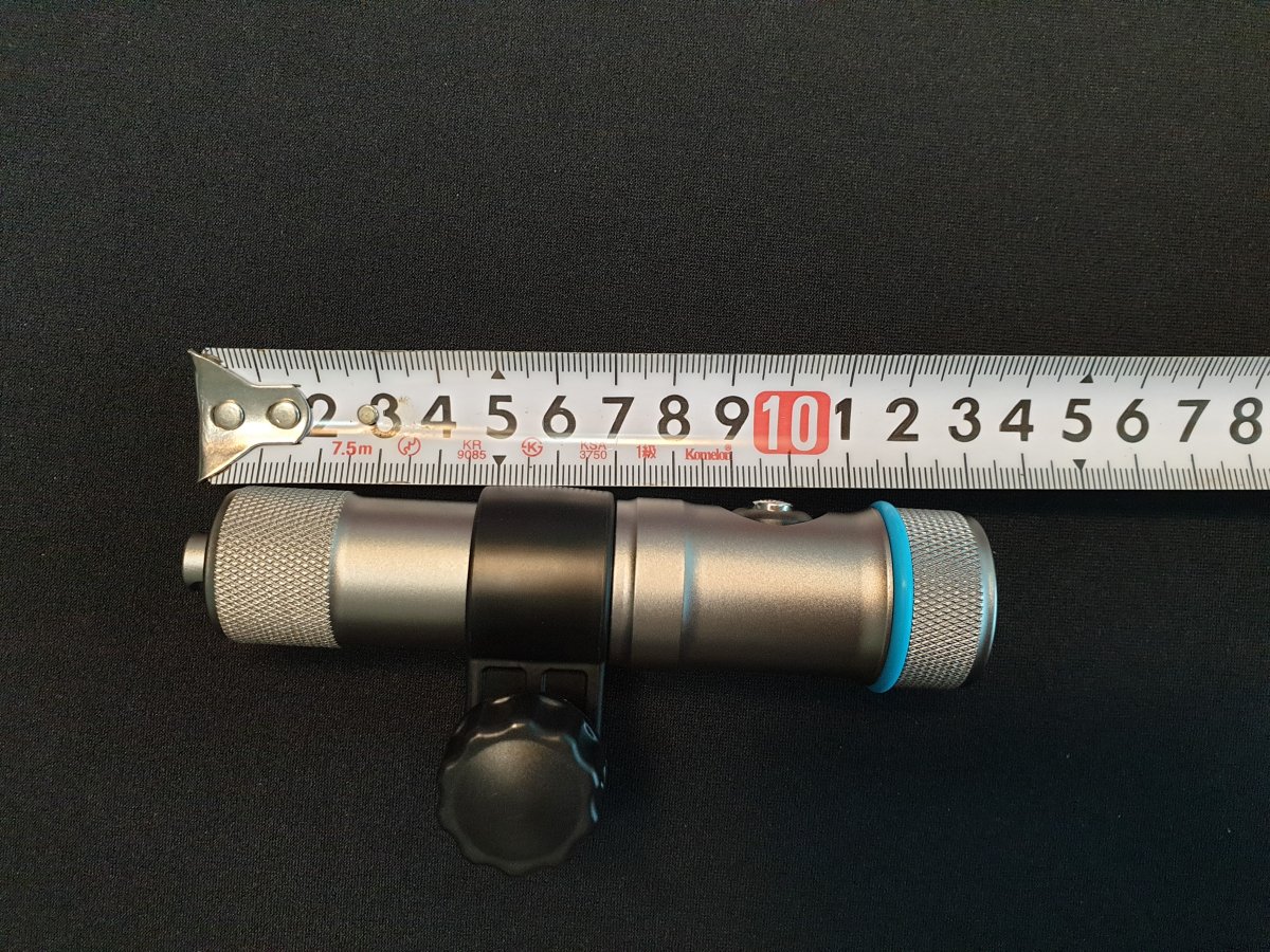

  4. I am using M1OOO WRA Focus light from a Chinese company called X-ADVENTURE.  White 1000 lumens 500 lumens 250 lumens brightness and red 200 lumens 100 lumens brightness.  It is 13cm long and weighs 130g excluding batteries. I measured the size and weight myself.
    The angle 100 degrees.
     I use 18650 battery. There is also a strobe detection auto-off function.
     There are models that include snoots, but I bought a cheap snootless model.
    I bought it because the cost including YS adapter was low, but I am satisfied with the quality.
     Quality and style are very similar to WEEFINE. But it's cheaper.
     I've been using BIGBLUE products as focus lighting and exchanged them for X-ADVENTURE products for about a year, but they're still working well without any problems.

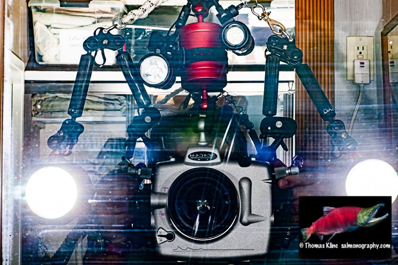

  14. I found a shot of the scuba set up from my trip to Kauai in 2019. This was my test to make sure both strobes were working prior to a night dive. I left for the dive shop with the float -arm attached since I used short arms for the macro shooting (was able to fit in bag). Bathroom mirror in condo. Also a record that I used a dome port with the 60 Micro Nikkor for the dive! Dive computer strap can be seen. Note that the lights are flopped down (for transport) on YS segments that I forgot to mention above. Inons are not the ball type light (per Adam).The 5 degree light is the wider one! One big advantage of these lights is that the on-off switch is on the rear facing me. The inked in T and W are my attempts to idiot-proof the zoom knob. Also written on the top surface of the housing. Also on my other Seacams. I also have "zoom?" written on the top of the VF bump. This is because I do a lot of remote photography that does not involve using a viewfinder. Yes, the zoom has not been correctly set a few times! The ring rotates when mounting the lens into housing so gets re-set.
    Edited by Tom_Kline
