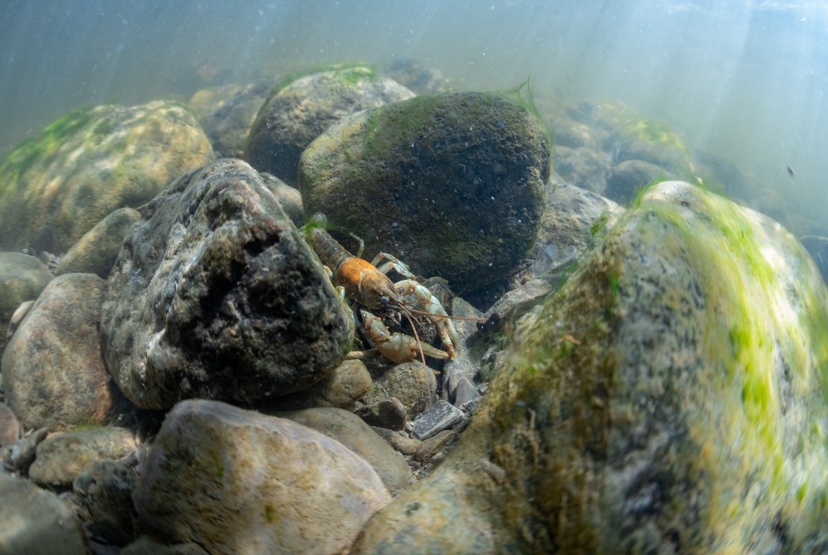

  7. I routinely use a Canon 8-15mm fisheye with my Sony A7III and an Aquatica 4" glass dome. I really like the setup as I mostly use it in small streams where I need to cramp my camera between rocks to get close enough of critters, it will be impossible with a larger dome. The downside is corner softness, which really is up to your preference. Here's an example of an uncropped crayfish picture. Of course, the cropped version don't really show the softness.

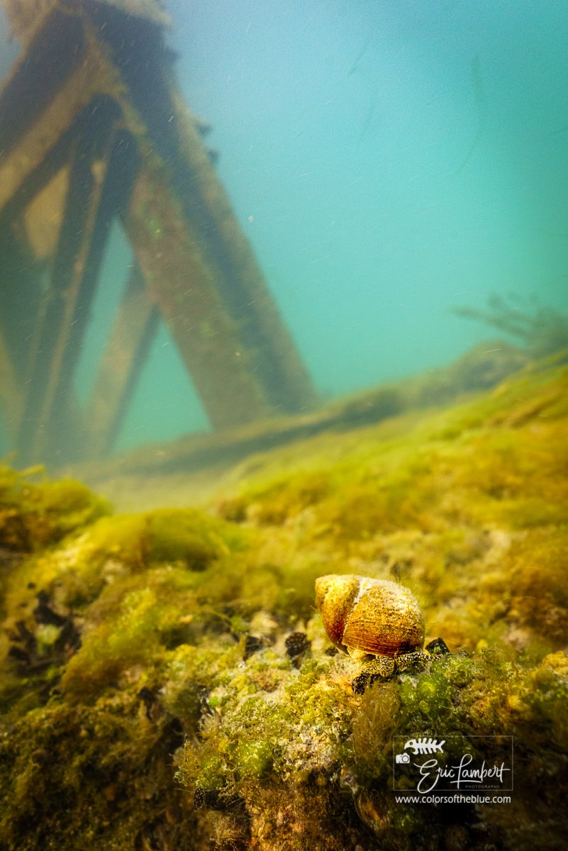

  8. For CFWA, and specifically Close Focus Wide Angle, what you/we want is to focus very close to the subject (almost Macro) , but at the same time, include the background details (where and how the subject lives) in the photo frame.
    Please see below an example, also taken in a river (Switzerland) and not in the sea. A water snail lying on the bottom of the river, under a bridge.
    For such photo, i am using the Tamron SP 20mm F/2.8 Di III OSD M1:2, a great lens despite its very low price. It allows Macro at 1:2 and allows to include decent background and almost 100° Field of view when focused at the Minimum Focusing Distance which is 12cm.
    To achieve this very short Minimum Focus Distance, i am using a 100mm dome port (N100) on a Nauticam Sony A1 housing. No extension ring. I have 10cm between the focal plan and the front of the dome. Which leave 2 cm...
    The image is uncropped. And you may see that corner stay sharp.
    Edited by lambee01
