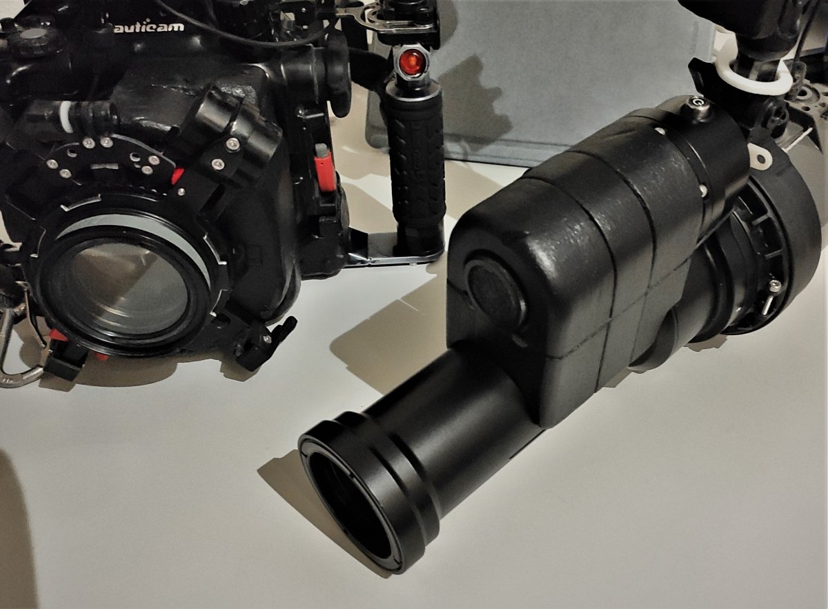

  1. Trying my luck at shooting with the new Marelux SOFT snoot with the Inon Z-330 dock.
    All photos with Sony A-1 and Sony 90mm macro, Marelux MX-A1 housing with cross bar and one centered ball-head. I just used a single clamp to center the SOFT over the center of the macro port, set the Inon to full power F/5.6 to F/9 at ISO 400 to 640 and because I was diving in shallow water at Blue Heron Bridge found night dives to work best.

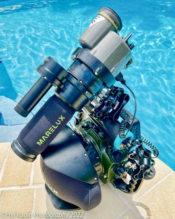

  4. Hey Phil, would love to see a picture of your setup with the float arm + snoot

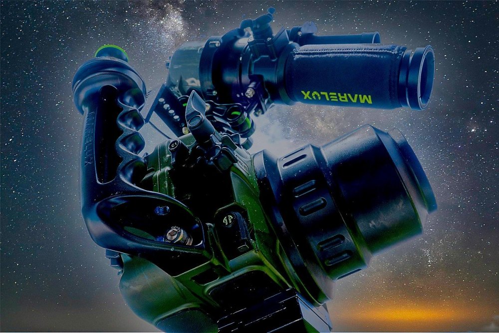

    This is a work in progress for me and the attached photo is using a Nauticam float arm clamped to the flash arm ball-heads. I am working on a W/A project at this time and didn't want to change ports for a quick pic. I lent the SOFT to a friend and he used the short fat Inon float arm to support the SOFT.
    Bottom line is that I am still dialing in the different possibilities for buoyancy.
    Also be aware that one of the reasons Marelux and others loan equipment to reviewers is for product feedback. Marelux is aware of feedback on the buoyancy concerns and I suspect they are coming up with a solution for this issue.

  12. 21 hours ago, shakuiel said:
    Is it really THAT negative?
    having used it on almost every dive for 3 weeks in Bali recently, yes it is.  When I hand it to my dive guide I have to let air out of my BC.  It's extremely unwieldy.  It does work as advertised though.  It did not seem to be very efficient in focusing the light - I kept my Z330 at or close to full power, which I believe is similar to how a Retra LSD performs, but I have no direct comparison.  Obviously the perfectly aimed focus light (with its own battery) and the wheel-adjust beam size are the major advantages.

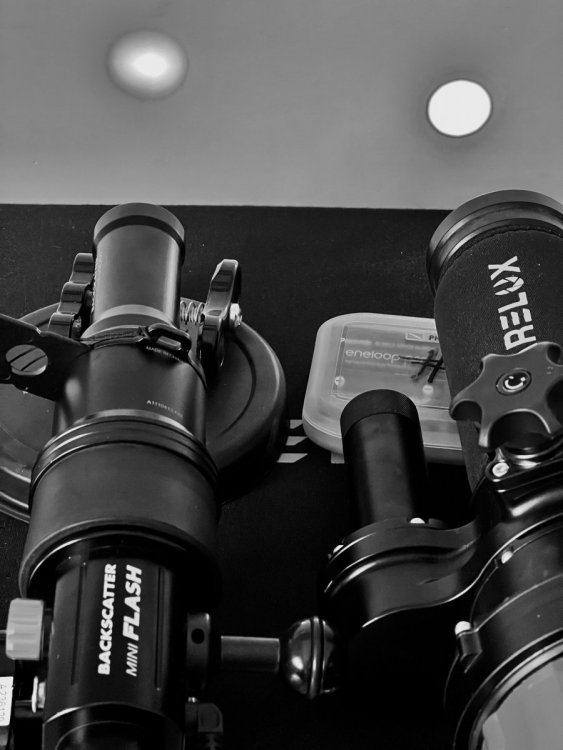

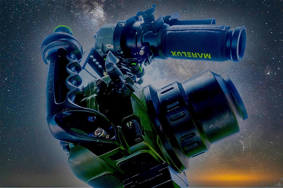

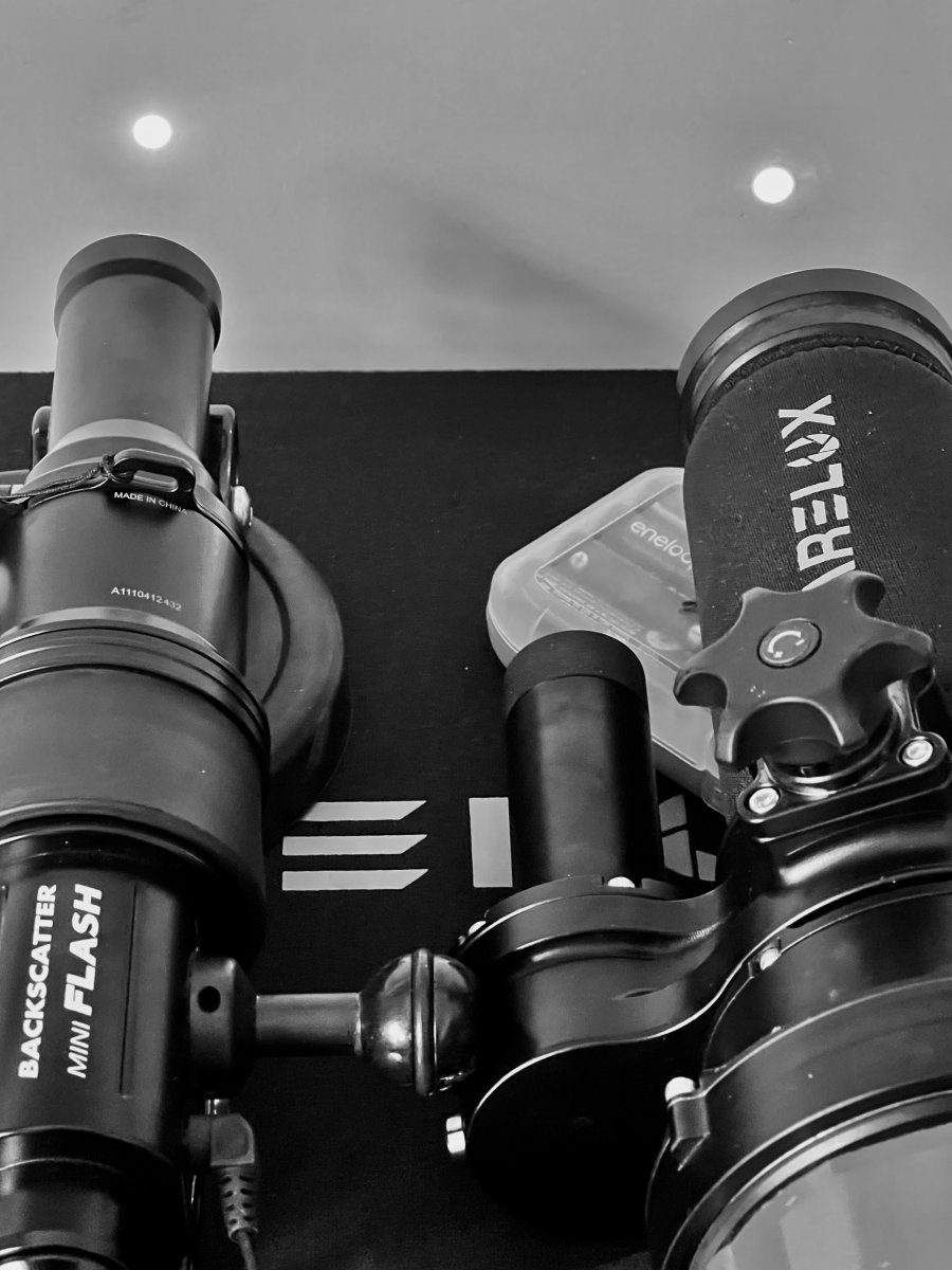

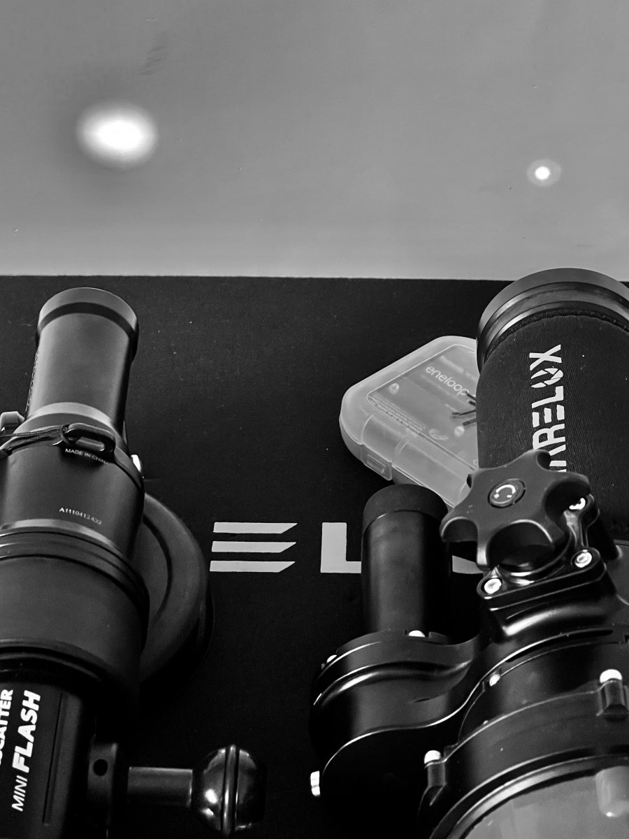

  15. I have made several dives with both and they are both very useful tools. Each has its own upsides and the smaller size of the MF-1/OS-1 snoot combination is obvious. It is also clear that the MF-1 alone would not be anyones first choice for doing wide angle.
    The SOFT on the other hand can be used with a verity of excellent wide angle strobes and is I think one reason it is getting so much interest. Second is the fact that the SOFT has its own aiming light with a battery separate from the flash that last far longer than the MF-1 battery powering both the flash and the aiming light.
    The MF-1 has from the Backscatter page "dual-beam LED lights run at 500 lumens on high power" the Marelux user manual says the aiming light is 180 lumens. The Marelux user manual also says the ideal working distance for the SOFT is 120-180mm (12-18cm) which is about the minimum focusing distance for 90mm to 105mm macro lenses on full frame cameras with a closeup lens in the +10-+15 range behind a flat port, approximately.
    First image is both lights at 120mm, MF-1 aiming light on high power, same size light circle.
    Second image same as above at 50mm with the OS-1 using the smallest hole in the aperture card.
    Third image is from 120mm with the smallest aperture card for the OS-1 and the SOFT set to slightly larger than the smallest iris setting. From 180mm the SOFT retains a nice even circle of light and the OS-1 is just a large dim circle of light. The conclusion for me is that you need the aiming light much closer (about 25mm) with the MF-1/OS-1 to get the same intensity and light quality as you do at 50mm with the SOFT.
    In the end the MF-1/OS-1 combination provides excellent light at close distances and is more well suited to smaller format/compact cameras while the SOFT is excellent for full frame where you may need higher F/numbers and more distance between the flash head and subject.

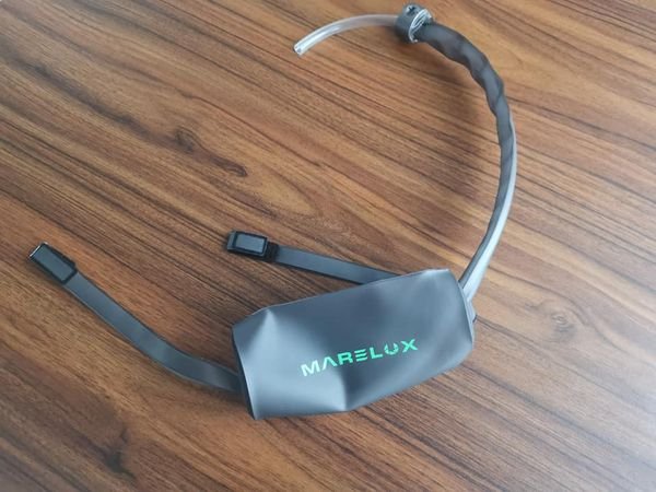

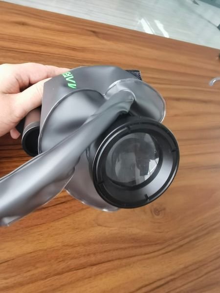

    Marelux today released images of a prototype buoyancy device to offset the weight of the SOFT and for other needs.

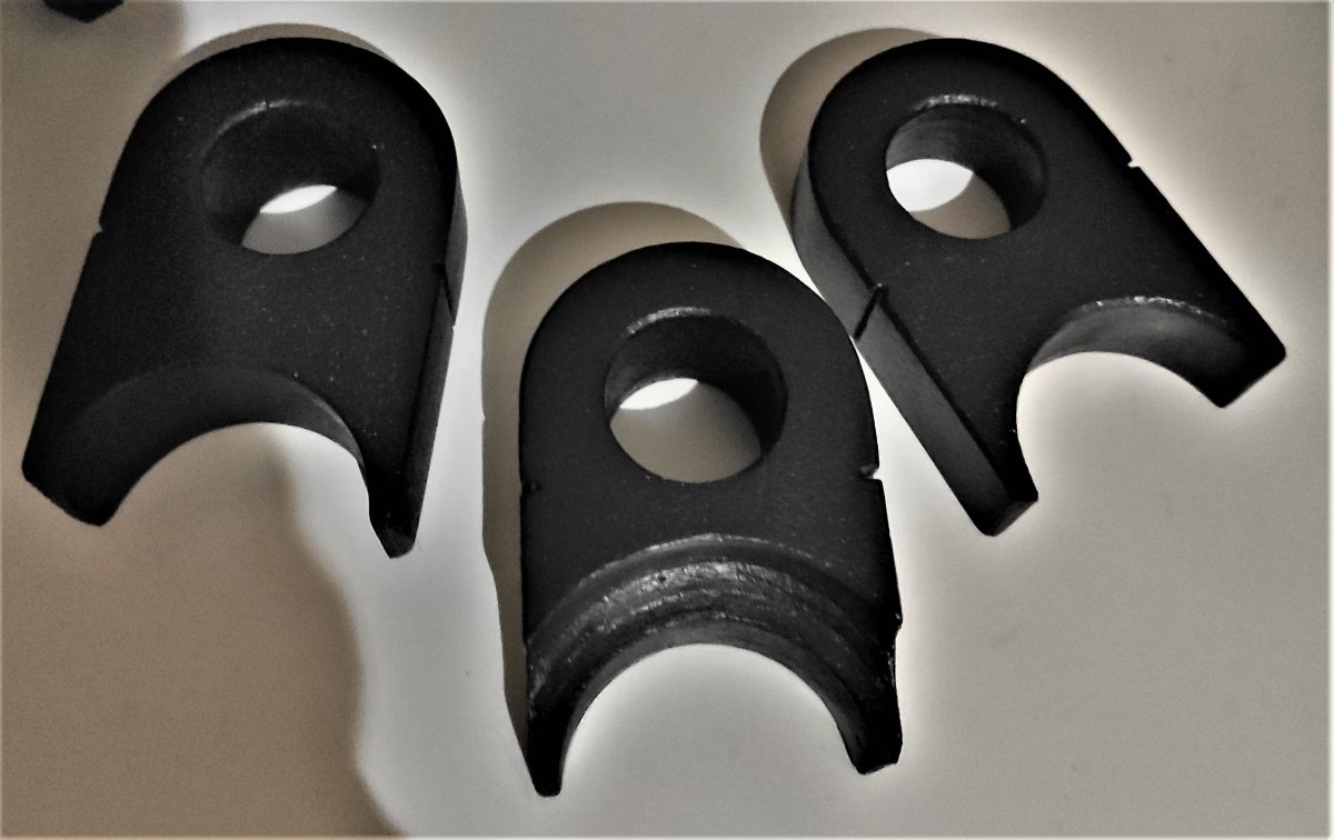

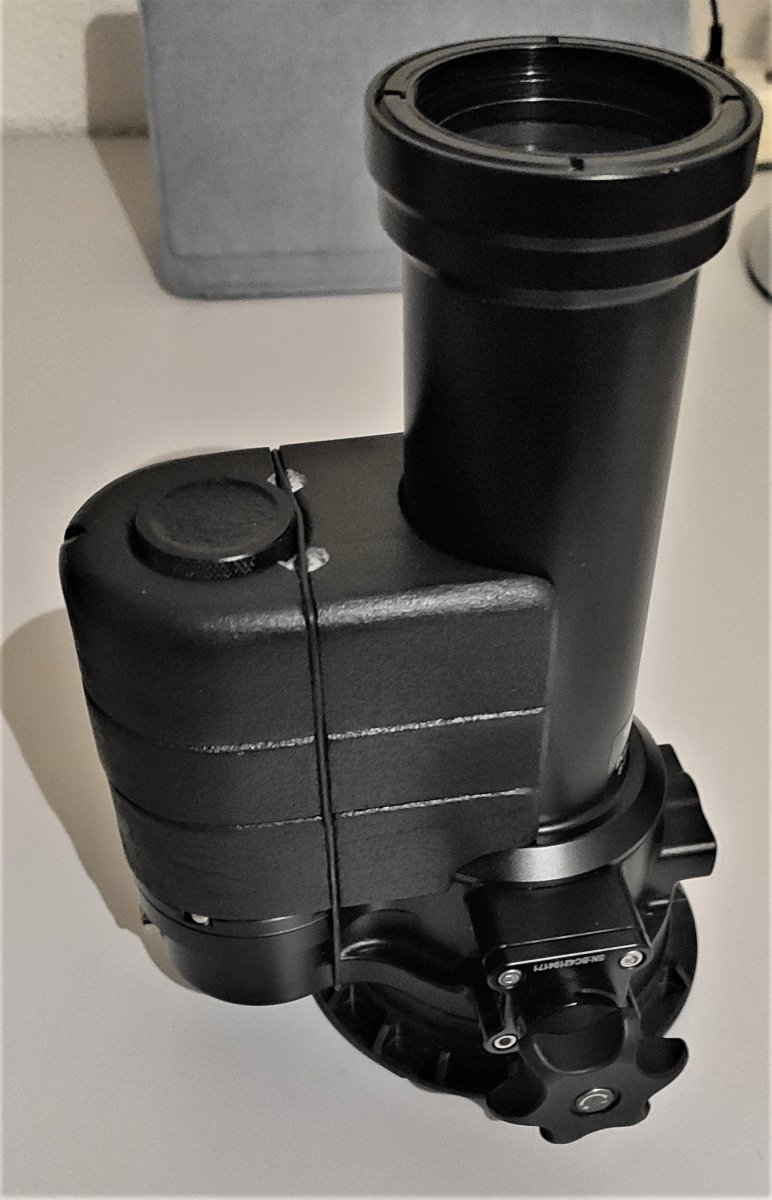

  18. another idea of a self made float for the Marelux SOFT snoot.
    cut out of a piece of closed cell hard foam. Since the pieces are pressure stable the buoyancy doesn't change with depth.
    They fill the gap between the focus tube and the battery compartment and so the size of the snoot wont expand much.
    IMG_20221013_194706.thumb.jpg.1d9052002f79c0f32d2a3d1e9a53f196.jpgIMG_20221013_195000.thumb.jpg.aedf34b7ed1955c91c29bae00b2defd0.jpgIMG_20221013_201157.thumb.jpg.2588cade9d5d613c880dbb80d6593c24.jpg.
  19. Very neat! What did you use as the cutter?
    This looks much nicer than the original prototype. Marelux take Note!
