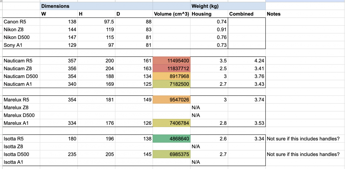

  11. @ChrisRoss I am considering marelux, but I hadn't looked in to Isotta. I really hope one of the manufacturers make a seriously compact housing. Here's my little comparison chart so far - my concern is that a manufacturer may have done the dimensions with/without the handles (they don't specify).
