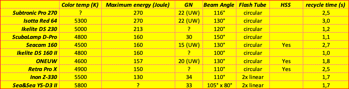

  1. We have successfully managed to destroy our second last Sea&Sea YS-D2 strobe and are left with three Z-330s and one YS-D2 (two UW-photographers in family). The original plan was to replace a YS-D2, in case of failure, with a Z-330 (so that we have 2x two Z-330 for the rigs) and to use the remaining YS-D2 as an external strobe. This is not possible now, because of the discontinued Z-330. Also the YS-D3 II, which would be in a similar nice as the Z-330, is, because of the bad experience with YS-D2 (four flashes died since 2017), out of discussion...
     Since I could not find a dealer who has some remaining Z-330 in stock (we are very satisfied with the Z-330 strobes), I fear I have to look for another, available model. I should also say that I plan to acquire a FF camera in the near future (Sony A7RV) and therefore a strong strobe model may be a good idea. From the data available in the Internet, I have compiled a table, for comparison of different models (corrections/additions welcome; did I overlook an important one?). Money is a factor, but not the most important one, quality and durability are rated higher. Also the GN is not very important, as this is measured under too many differing conditions (interestingly the weakest strobes have the highest GNs :lol:):
    From this comparison (and what I read here in this forum), I tend towards the Retra Pro X flash (output, color temp, o.k., HSS, but recycle time long, in comparison), but also the Seacam 160 (similar properties as Retra, but as far as I understand the accus are in the flasharms (=expensive to replace when accus have reached end of lifetime)) or the Ikelite DS230 (relatively strong and quick to recycle, but no HSS and optical triggering complicated) look attractive. The Isotta Red 64 may also be interesting, but it seems it does not exist yet...
    What is Your valued opinion?
    Thanks, Wolfgang

  2. If your primary worry about Retra is recycle time, then just get the superchargers. I shoot a pair of Retra Pros (non-X) with superchargers and couldn't be happier with them.
    Seacam 160D use internal batteries, albeit proprietary ones. The battery arm solution is Subtronic.
    I don't know about Scubalamp D-Pro, but their earlier D-MAX performed significantly below advertised specs.
  3. You should add size and weight to the table, many on your list are twice the size and weight of the Z-330.  I always thought the Retra had a 130° beam - can't find the spec on the website anymore.
  4. I used many strobes and have been very happy with INON both small and larger ones up to Z220.
    Also had Sea&Sea and Olympus ones.
    Two years ago I went to the Retra Pro.  Great opportunity with HSS and great quality of light.   However they are very picky about batteries and without superchargers and 16 eneloop Pros you will barely make 2 dives.  So keep that in mind.  Not many other choices with compact sizes and enough quality power for WA.
    Andrea
  5. I know everyone will probably recommend the strobes they own, but I'm really happy with my Retras with the superchargers. Plenty of coverage and great light on a Sony A1 with the WWL-1. Much better than my old Sea and Sea YS-D1's
    Mike
    I also did not find the angle of beam on the Retra Homepage. Here on this Backscatter review it is said "The beam angle is 110 degrees and can be expanded up to 130 degrees when shooting with the wide angle diffuser.", but this is the Retra Pro model and now they have the "Pro X" model. Confusing...:mellow:
    https://www.backscatter.com/reviews/post/Retra-Flash-Underwater-Strobe-Test-and-Review
    That is the original Retra pre using circular flash tubes, I expect the beam angle is greater with the circular tubes.
    This is the original article
    https://www.retra-uwt.com/blogs/news/comparing-light-ouput
    When you look at the image with the tests without diffusers you see that the new retra flash is much wider than the original
    However when you look at the shot with diffuser the new flash due to the design benefits less than the diffuser and the gap is not so large
    The measurements that follow are without diffuser which is not how you would use a strobe with linear tubes including the z330
    There is a useful table of physical dimensions and weights
    There is no doubt that retra products are well built by someone who knows their stuff very well
