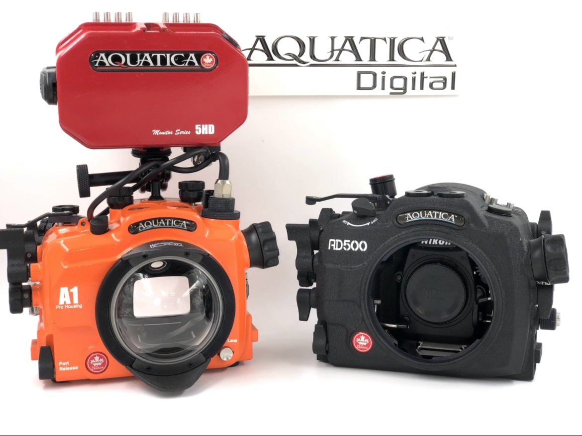

    Here are side by side our D500 and A1 housing with our 4 inch glass dome,it gives you an idea of the sizes of both housings.
    Hope this helps .
  4. On 5/3/2023 at 3:28 PM, Aquatica Digital said:
    Hi Adrianna
    To answer your original question
    Hope this helps .
    Thank you for this comparison. Have you had anyone test out the Sony FE 14mm F/1.8 GM lens? Would that lens perform best with the 9.25” glass dome port?
