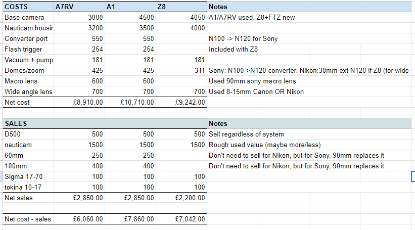

    (prices in GBP, updated with some extras)
    I've done some maths and I'm seriously considering going over to Mirrorless now that we have stacked sensors. My reason for upgrading in general is *mostly* topside wildlife action, as I don't believe the benefits underwater are that vast. Having said that, I believe some mirrorless sytems will be a bit smaller underwater, like the Sony compared to the Nikon.
    Ultimately, for each system, moving from D500 to the following has pros and cons, as far as I see them:
    A1: decent battery life, can probably help with some tracking underwater, some replacement of lenses but overall macro and wide are possible. Stacked sensor and amazing EVF should lead to a great shooting option. Topside its seen to be a good option for wildlife action.
    A7RV: decent battery life, can probably help with some tracking underwater, some replacement of lenses but overall macro and wide are possible. Good EVF should lead to a great shooting option, but not stacked and will lead to blockouts. Most affordable swap overall. Topside its seen to be a good option for wildlife action.
    Z8: poor battery life, might help with some tracking underwater but general consensus is that it is worse than Sony. Worst EVF in terms of resolution but apparently really bright with high refresh rate, stacked sensor with no blackouts, so should be a great shooting option. Topside it's seen to be a decent option for wildlife action as tracking isn't as good as sony?
    Costs ranked to swap (lowest to highest): A7RV, Z8, A1
    IQ: I'm assuming with the right set up, they'll be very similar, with A1 having higher resolution, but I wouldn't really need 60MP - I think I'd be in trouble if I needed that much to crop.
    Whilst I know Z8 underwater is a theoretical concept - we can lean on experiences from the Z9 as it's practically the same camera sans grip.
    I wanted to see what people's thoughts were on this? Has anyone shot both Sony A7RV / A1 and Nikon Z9?
    Edited by sinetwo — Updated sheet
  2. Any reason you're only looking at full-frame? If you're comparing a DX DSLR to stacked-sensor mirrorless, then OM-1 and X-H2S should probably be included.
  3. I had a really hard time finding A1s used for less than 5800, so I’d add another bit to that column :cry:
    Edited by ScottyR
  4. I'd also add that the prices of the Nauticam housings in your spreadsheet are lower than I am aware of by about 1k each.  Plus flash trigger and vacuum valve (if not transferable from your current setup... which the flash trigger unlikely will be) also add to the cost and can be another 500 (easily).  The Nikon Z8 has a lot of potential and I am looking forward to some tests of it underwater as the housings become available.
  5. 35 minutes ago, ColdDarkDiver said:
    IPlus flash trigger and vacuum valve (if not transferable from your current setup... which the flash trigger unlikely will be) also add to the cost and can be another 500 (easily).
    Interesting, with the D500 and the Z8 housings these come as standard, whereas, as you say, with Sony they're not.
    But the housings are priced roughly right, for the UK - they're definitely not off by £1k.
    Edited by sinetwo
    Am not aware of any new housing that comes with a vacuum valve or trigger.
    If you have those items they may be compatible
    Edited by Interceptor121
    https://www.nauticam.com/products/na-z8-underwater-housing-for-the-nikon-z8-camera
    1. The NA-Z8 comes with the manual LED Flash Trigger (#26350) pre-installed. An optional TTL LED Flash Trigger is available (#26308).
    2. The Nauticam vacuum check and leak detection system is shipped with NA-Z8 as standard equipment. Combined with an accessory vacuum valve (PN 25624), this monitoring system provides constant updates on the water tight and safe-to-dive status of the housing.
    The numbers make more sense if you assume they're UK pounds rather than US dollars or euros.
    I realise that wasn't in the spreadsheet now, thanks for correcting.
  10. https://www.nauticam.com/products/na-z8-underwater-housing-for-the-nikon-z8-camera
    1 yes strange
    2 means you need to buy the valve like all others
    Ah true, at least it has the trigger included - original post updated.
    Edited by sinetwo
