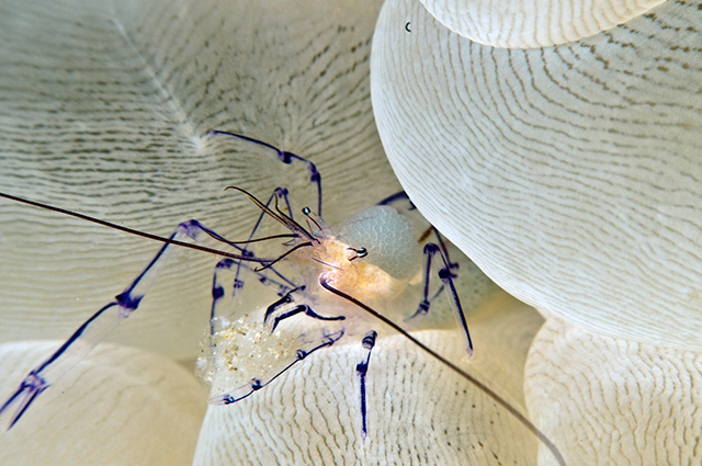

  17. I use a Nikon AF-105-VR almost exclusively. It has a 6-7" working distance (Distance from the end of the lens) to get 1:1. A subsee adapter will give 2.25:1 at a workind distance of about 3", somewhat less if you back up just a bit.
    Here is a Bubble Coral Shrimp at more than 1:1. It is full frame. (I am not sure of the actual magnification but it is better than 1:1.) What is nice about this shot is that it is still a shot of the critter and the environment,
