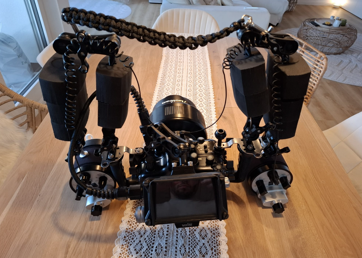

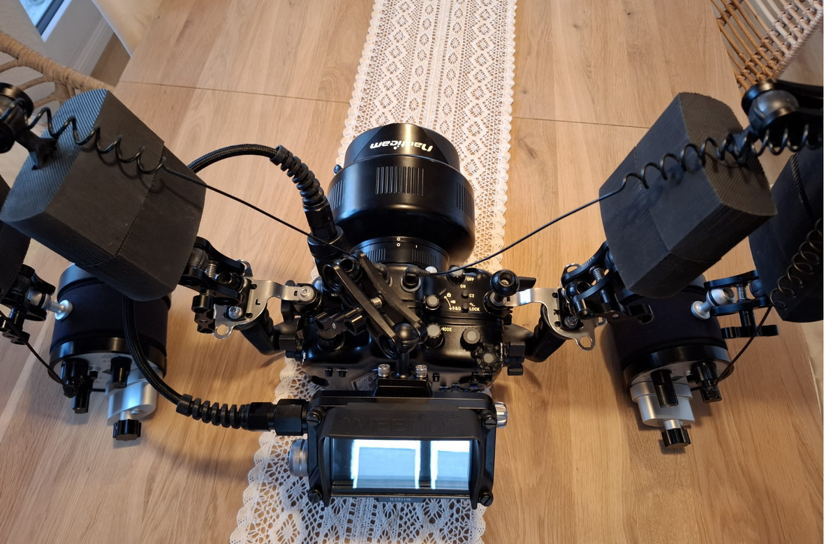

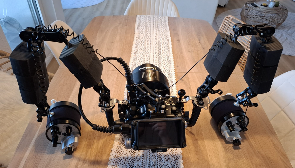

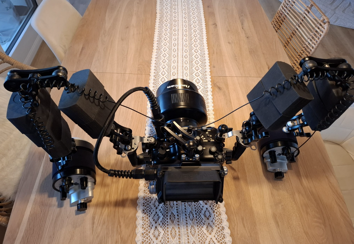

  2. To answer another question from the TO. I'm using a Sony A7IV, and the camera is set to use HSS (no need to change it). Only the flash is set to whether HSS or normal mode is used. It's quite possible that this doesn't work with all cameras, but it does with my Sony. I also use the neoprene covers and the bumpers. I like everything black, and it also provides excellent protection for the strobes :-)

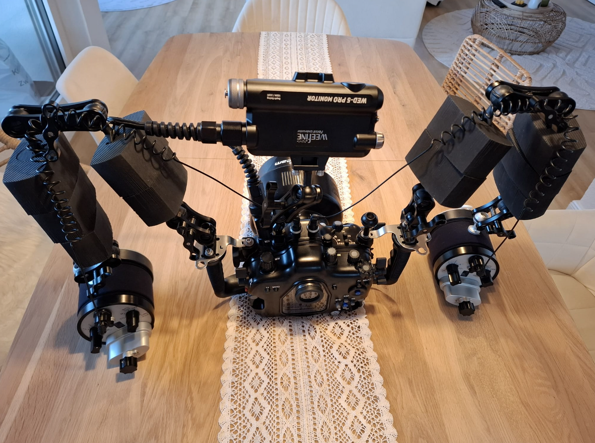

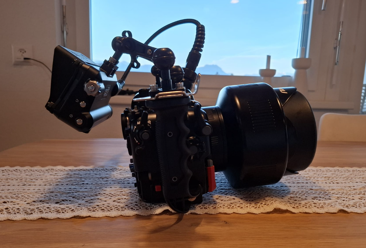

  3. I don't know what kind of float arms you use, but the cable routing is actually a little different, and depending on how the monitor is mounted, the cable can get in the way (in my setup). I mainly use the monitor behind the camera and not above it. This is the best option for me, and I can move the flash arms freely. It also works well when transporting with a lanyard. Incidentally, the cable is much stiffer, nothing like the previous model. It's very difficult to bend. I hope it lasts longer now. Here are a few other examples. It sometimes lightly touches the float arm.

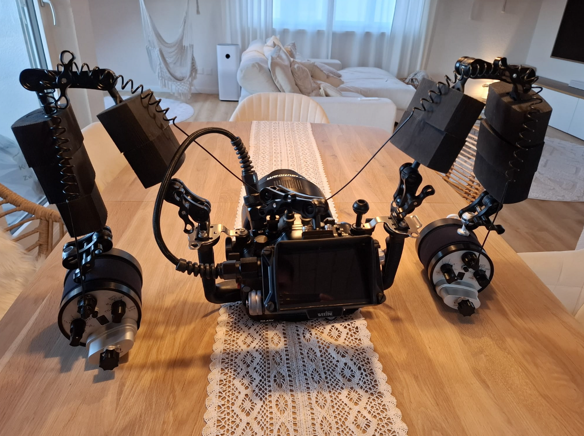

  5. Hello everyone. You can find the manual for the Weefine WED 5pro here: https://www.weefine.com/static/upload/file/20250903/1756894011377368.pdf I've had mine since last week. It's a light and fine little monitor. The monitor is very bright and I ran it non-stop for 1.5 hours today with a 5000mAh battery at the brightest setting. There is now also a 6000mAh battery available in this size (but without a USB-C charging port). so battery life is superb. The mounting ball can be mounted at the top or bottom, and the sun visor can also be rotated. In addition, the image can also be rotated in the monitor. This can also be programmed to a short key. If you have any further questions, just let me know.
