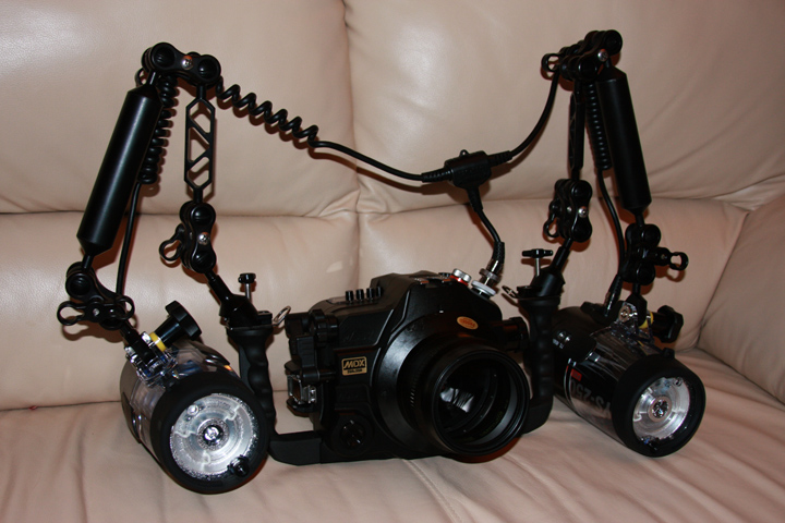

    help with the extra cost. Thanks again! Special thanks for showing your rig up Steve. I was getting a little concerned that the whole rig would be getting
    large and interfere with diving enjoyment. Taking a look at the photo though, it does not look too bad.

  10. It's a beautiful thing. :) It's not your compact and when you first put it together you'll wonder how you'll ever get it to the boat. But once you get it in the water it'll go right where you point it without thinking about it. Good luck and have fun!
    Steve
