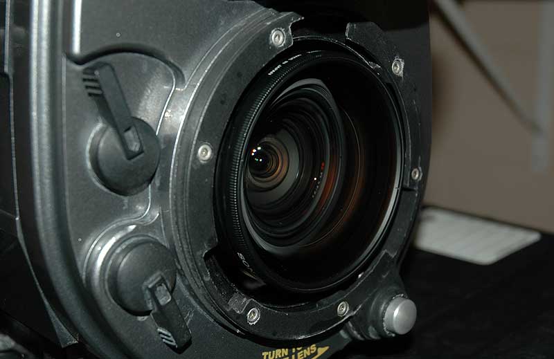

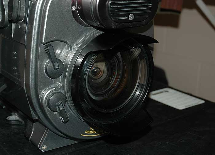

  7. Jules,
    I have very successfully cut a magic filter to fit directly onto the camera, holding it in place with the inner retaining ring from an old filter. However I do use the 94 degree port as it is a beautiful lens. With the magic filter in place I can use a dioptre in the filter arm giving more flexibility. If I have lights fitted for macro subjects at depth. I switch to auto WB and it balances even with the magic fliter in place. This saves me losing the MWB setting when I am too deep to re-balance in ambient light.
    Seems to work a treat.
    Roger
