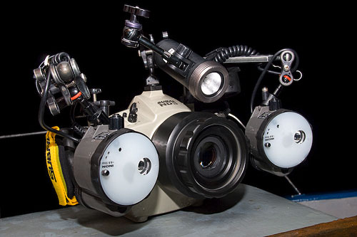

    I agree that the port mounting point on your D300 housing is closer to the camera than it is on the D3 and your D200 housings. Which I find surprising. I already emailed Ryan about your port.
    Here is a photo of your port fitted perfectly on the D3 housing. You can see if you look closely at the picture that the is a small gap between the front of the lens and the glass of the port.
    So the problem does seem to be related to the D300 housing only.
    Alex
