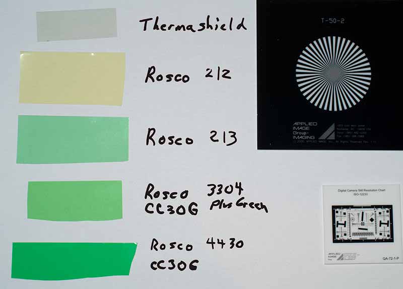

  17. I received a my IR strobe gels and my glass resolution charts. Here's a picture:
    The gels I'm testing are the Thermashield IR reflecting gel and the Rosco 212 and 213. The other two gels are CC30G variants I've shown just to give an idea of color. The two resolution charts are glass and I hope they will be suitable for use in a pool. I need some sort of jig before I attempt to perform any resolution tests. The circular pattern is 2" in diameter. The other chart is 50mm wide and will be suitable for macro testing. It will be easy to test for resolution beyond what any of our cameras currently do.
    I used the same deep red IR filter as before and shot a series of combinations holding the appropriate test gels over the strobe tube. Here are the results (remember, IR is already down at least 1 eV):
    • -1.22 eV : 212
    • -2.13 eV : 213
    • -2.19 eV : 212+213
    • -2.47 eV : TS
    • -3.11 eV : TS+212
    • -2.95 eV : TS+213
    • -3.22 eV : TS+212+213
    The 213 would have a milder effect than a CC30G filter on a strobe but not all people will prefer that. The 212 will have a moderate warming effect in combination with a CC10G green filter. For cooler strobes like I intend to use, the effect of the 212 will be more subtle than the 213. The 212 may be too warm for a conventional warm, wide angle strobe though. I don't expect anyone to like using both together.
    The Thermashield filter is a little more effective than the other two and is very close to neutral. It combines well with the other two as well. There are some problems, though. First, there are warnings against rough handling and the filter must be properly oriented on the light source (yet you can't really tell the sides apart without marking them). Second, the product is specifically not approved for use with Xenon light sources most likely because they are too hot. That may rule out Thermashield installed inside the strobe port as I hoped to do. Finally, Thermashield may not work or be stable underwater. Experimentation will be necessary.
    I'd still like to find a source for a conventional ICF in a flexible film but I'm not hopeful.
    While these numbers aren't very impressive, keep in mind that some of the light is actually visible red due to the IR filter design I chose. I can't tell by this test what the balance of IR wavelengths is nor how damaging to an image they might be. The real problem with IR is that our lenses aren't designed to focus it properly. It may still be the case that IR is no problem whatsoever underwater. It's clear to me that I can get all IR and near-IR at least 2 stops below visible without considering water absorption at all. I'm optimistic. Regardless, macro is a slam dunk because of the B&W 486.
    Edited by craig
