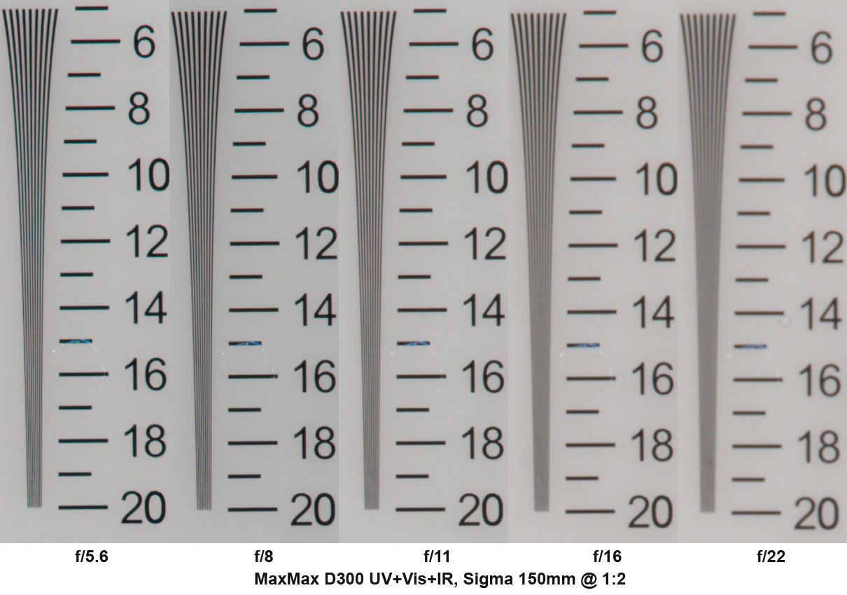

  3. Here's my first resolution test shot in air on a copy stand. My chart is 50mm wide and I used a Sigma 150mm at 1:1. Sorry that the image says 1:2. I used the popup flash so the lighting isn't too great and the chart a some specks of dust. It does what it needs to. ;-)
    These conversion were done with ACR, linear, with only exposure and white balance enabled. No sharpening or noise processing is done. I also examined conversions from Aperture 2.0 and RPP. RPP produces slightly more detail particularly at higher ISOs and noisier images. At base ISO I find the differences (from a resolution perspective) not great. There are differences in the demosiac implementations that effect detail and moire in these tests slightly. The conclusions will be the same though.
    Since the chart was shot approximately how it was intended to be, the numbers correspond to 100's of lines per picture height. The D300 is outresolving this chart below f/11 as expected.
    Moire is visible at f/5.6 and f/8, almost gone at f/11 and eliminated by f/16. You can also see the onset of softening from diffraction at f/11 and the obvious effects beyond that. Resolution is noticably reduced here above f/11 just as the "diffraction limit" says.

  6. I seem to be unable to figure out what magnification is anymore. The test chart width is 36mm. On the D300 magnification on these tests is 2:3, not 1:2 as originally indicated. I can shoot this chart with the 70-180 on the D300 but not on a D3.

    I'm comparing the modified D300 to a stock D2x. The D2x is known to be reasonably sharp. Using the Sigma 150, I've compared the two cameras from f/5.6 to f/16. Some observations from Imatest reports:
    1. If the D2x is acceptable w.r.t aliasing at f/5.6 then the D300 is fine at f/8.
    2. At f/5.6, the modified D300 shows 15+% more resolving power on the slant line test than the D2x without sharpening. 35+% w/ sharpening.
    3. At f/16, the modified D300 shows 20+% more resolving power on the slant line test than the D2x without sharpening. 25+% w/ sharpening.
    4. Even without the AA filter, the D300 needs input sharpening and the results widen when the proper amount is applied.
    So, a big question is whether removing the AA filter benefits resolution in the diffraction-limited range that we typically shoot with macro. The answer appears to be yes.
