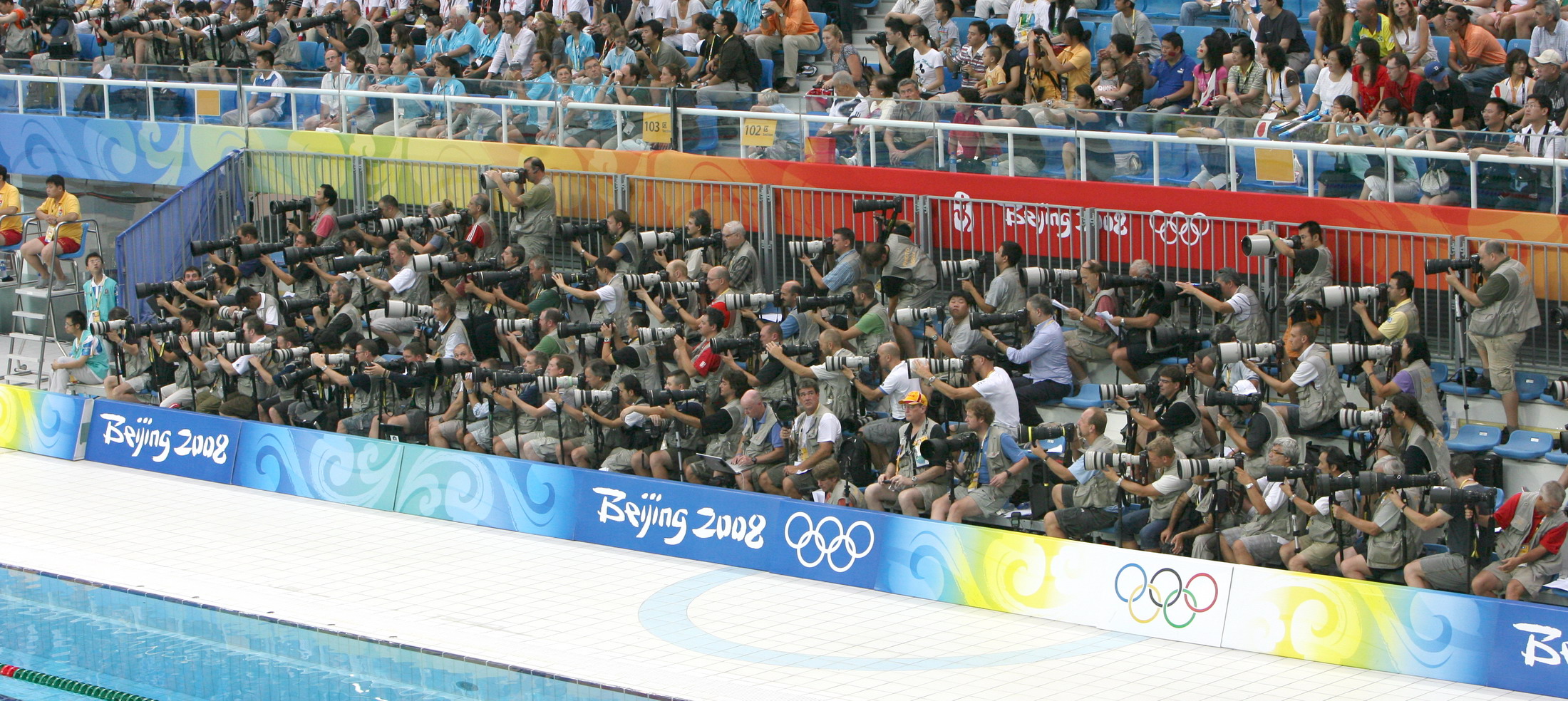

  19. :bananashark: I know but good to see more balance coming back to the Nikon / Canon mix at sports events. Sounds like this SI article used Nikon and here's a pic showing a return of some all black cameras in the mix. This can only be good for all of us in the long run with more competition.
    Boy, some serious glass there huh?
