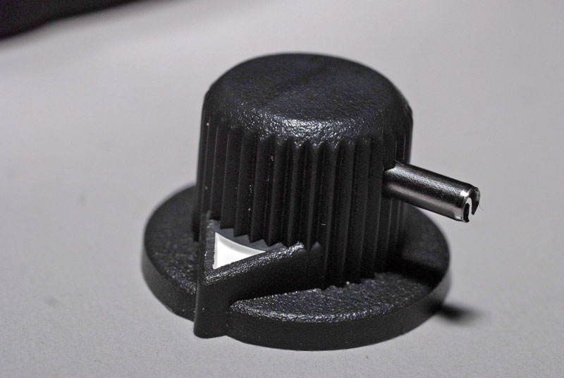

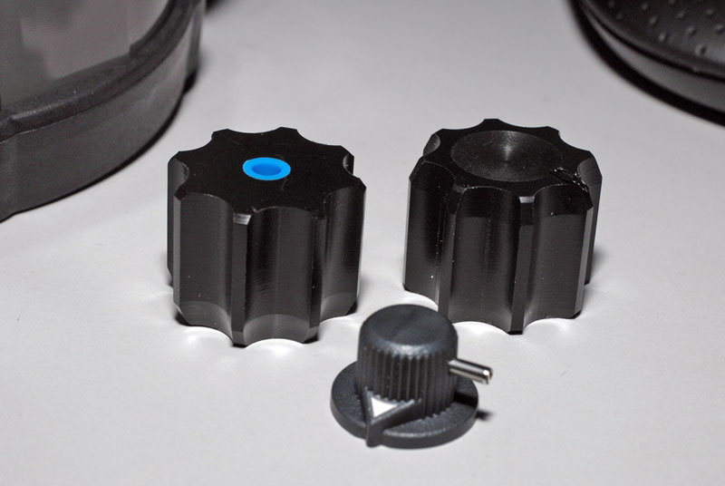

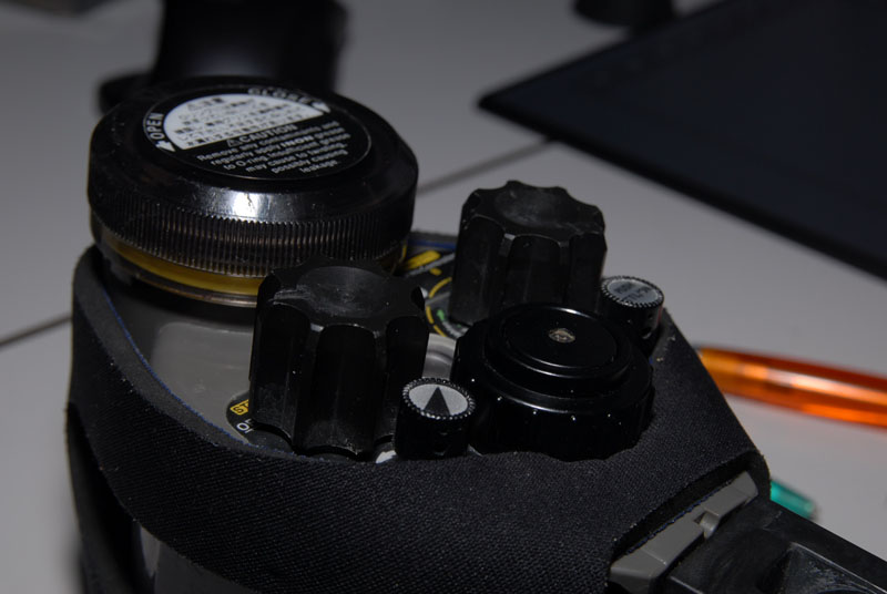

    Hi colleague INON users,
    i managed to take a few minutes to make a picture of my strobe buttons so you all can have an idea what it looks like. These buttons enable me to control the buttons with one finger in a 7 mm three finger glove.
    Best, udo

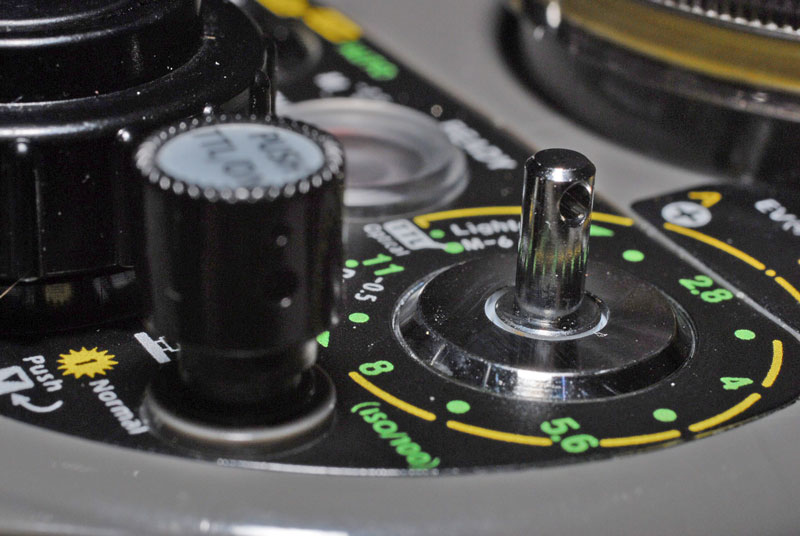

  16. Hi wetpixellers,
    I had a few PMs asking me for pictures about the buttons i use on my INON Strobes so i decided to post some pictures of how to remove the original INON buttons and the replacement buttons i use.
    First of all you need a tiny screwdriver to remove the little metal pin that mounts the original knob to the axis. This metal part looks as follows when it comes out of the knob:
    The axis of the INON strobe looks as follows. You can basiccally attach anything you like on the strobe as you can see:
    The buttons that i have on my strobes have a Blue insert of Swagelok Nylon tubing (i think it's size 5 but i'm not sure) which fits over the INON axis perfectly. Like this i have been happy with my INONs for quit a while now. As you can see my knobs are significantly larger then the original INONs. These enable me to operate a knob with one finger which makes sense while diving in cold water with 7mm three finger gloves:
    Hopefully this information is useful for some of you.
    cheers, Udo
