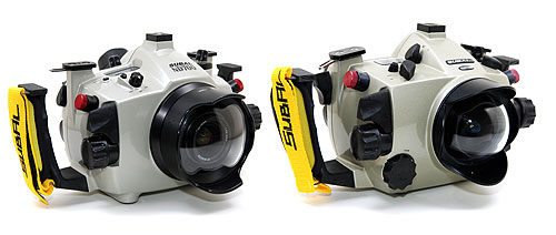

    Just to avoid any confusion the domes I was discussing earlier are not as curved and not fisheye compatible. This photo shows both. On the D700 housing, left, is the shallow curvature dome I used in all the photos above. On my F100 housing, right, is the fisheye mini dome.
    I hadn't realised that the mini-dome was incompatible with the Sigma 15mm hood. Good info Ryan.
