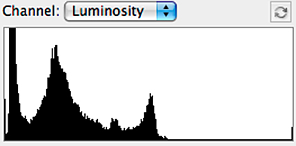

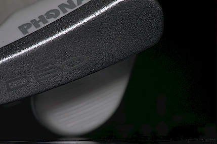

  10. Just for information, I did a test shot with my D300 housed, Sigma 150mm, Hoya +3, fairly near minimum focus with just the BigBlue light and no strobes. Focus is 4.5" from the port (in air). ISO 200, f/16, 1/60. This is a shot of an earbud on a shot glass and is a 1/10 reduction of the full frame:
    This was converted via flat tone curve and a custom, neutral profile with +0 exposure adjustment. Highlights just clip after white balance and the green channel is clipped in the RAW data. If I used f/22 and 1/250, the BigBlue light would be less than 3 stops below saturation! This is with batteries that aren't fully charged, too. The BigBlue light is 500 lumens, not 1000 like the big FIX light. You can see that, on an ISO 200 DX camera, these LED lights have output surprisingly close to the required strobe light. That's why I question this nuclear arms race for more focus light power. In a pinch, I could shoot macro with just this focus light.
  11. Just for information, I did a test shot with my D300 housed, Sigma 150mm, Hoya +3, fairly near minimum focus with just the BigBlue light and no strobes. Focus is 4.5" from the port (in air). ISO 200, f/16, 1/60. This is a shot of an earbud on a shot glass and is a 1/10 reduction of the full frame:

  12. Interesting and thanks for sharing.
    It would be more interesting if the test was performed uw and preferably in green silty water which is where I do most of my dives. ;-) As you know, water filters out the light alot...
    I agree, but the total light path was only about 10"/25cm.
    I can't see anything wrong in having as much light output as possible though as long as it's dimable (which it is on the LED1000).
    Yes, that's true but more output means a larger light or a custom battery with shorter burn times. In the FIX case it's the latter. Yes, dimming helps fix the burn times but you still have a custom battery and charger instead of AAs. There's always a cost to more power and it's the cost that's the downside. I always considered the FIX halogen light the best once you were underwater. It was out of the water where I liked it less than the older LED version. :)
    Peter Rowland actually did test using the LED1000 as strobe replacement on a few macro shots in uwpmag #46. It's hard to say on the images, but he claims that it worked OK. Notable though is that he beefed up the ISO to 800 (which of course worked nicely on his D3...). So, judging from that, it seems as if the LED1000 would need even more power (when used as a strobe replacement), not less! ;-)
    I haven't seen those images, but the D3 requires an extra 1+ stop of light (over the D300) and if you want dark backgrounds you need faster shutter speeds. Yes, you would want even more light as a strobe replacement, but that's not the point! The point is that the focus light, when putting out this much power, will have a noticable effect on your images even when you are using strobes. That's an unintended consequence that people may not be aware of and may not want. White balance for my BigBlue light is not the same as it is for strobes, so if I am doing creative lighting effects the focus light will be washing out my shadows and adding uncorrectable color casts.
    BTW, I wouldn't assume the FIX 1000 is brighter than the BigBlue without testing. It puts out twice the rated light but it may be considerably wider. Also, I'm not stating a preference for one light over the other since I've never seen the new FIX light. I'm simply throwing out some arguments for why another light might be preferred. More power and more beam width are better up to a point, then other factors become more important IMO.
