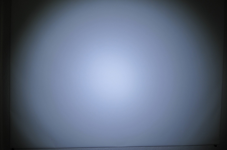

  3. Finally I have had the chance to test the FIXLED1000. Unfortunately I did not have the HG20DX to compare side by side, but I tested it against all of my dive lights (focus lights etc).
    In short, the FIXLED1000 is nothing but outstanding!!!
    I just love the wide, smoother beam (not 100% perfectly smooth, but almost) and the huge amount of power (1000 lumens!). If it's as wide as the HG20DX I frankly don't know (yet). But, it's surely wide enough for me.
    Why so much power you might ask?
    Well as it's easily adjustable it can be used for more than "just" a focus light. As a dive light it will lighten up the whole wreck or reef (well almost :turtle:) and as a video light it must be truly amazing. I often dive in dark relatively low viz waters and a light like this will make finding all sorts of things sooo much easier. No need to sweep, just point it forward and Sesame! In extremely low viz that wont work of course but I always bring a typical narrow beam dive light as well.
    It would be interesting testing how well it would work as a strobe replacement. I know UWP did a test, but I want to make my own in dark green water.
    Those of your diving in tropical waters probably don't see the point of this light. :D When I dive in e.g. the Red Sea, I never even bring a focus light. No need. And any cheap light will work great for night dives. But diving in dark, green relatively low viz waters e.g. in the Swedish west coast, especially in fjords where it's always very dark, a focus light is THE thing. I always strugle with altering the position of the focus light(s). I've tested multiple lights taped together or on individual arms and other things but nothing is good enough. Nothing even comes close to the beam of the FIXLED1000. Hey, I wish I had a diving store selling these babies! ;)

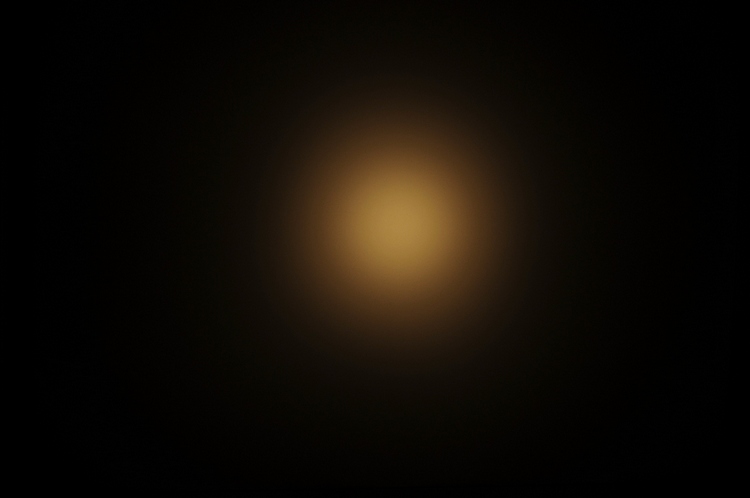

    To show how great it is, I did some tests. For all shots: D-SLR on a tripod, manual settings (f9, 14mm on a DX lens, ISO 200, 1/10, manual WB. The wall the lights are projected on is a 100" 4:3 projector screen.
    FIXLED1000 at maximum power.
    Ikelite Mini C Halogen with Fisheye Diffusor.
