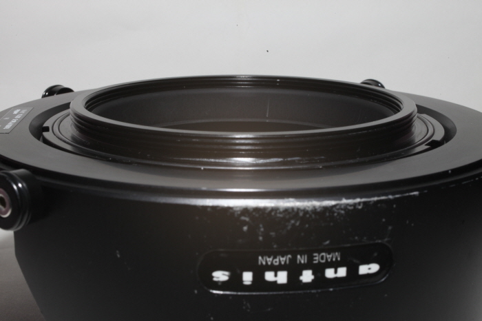

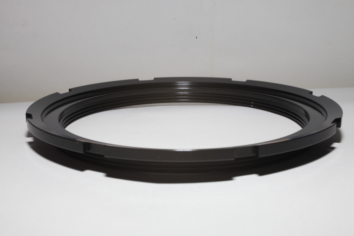

    It is interesting that you are using FP170 with M6/M5 adapter. I will post a picture showing why I could not use it with adapter.
    Sam
  6. It is interesting that you are using FP170 with M6/M5 adapter. I will post a picture showing why I could not use it with adapter.
    Sam
    First picture shows M6/M5 adapter surface where o-ring of dome port meets. As you can see it is tappered.
    Second picture shows surface of FP160 which is flat. it does not match. If adapter I have is old/wrong one
    than, please, somebody tell me so.
    Sam
    Edited by shchae
  7. First picture shows M6/M5 adapter surface where o-ring of dome port meets. As you can see it is tappered.
    Sam

  13. First picture shows M6/M5 adapter surface where o-ring of dome port meets. As you can see it is tappered.
    Sam
    Hi Sam,
    I do "feel your pain" with all these various Nexus port sizes. I sold my F4 master housing and ports when telecom and my job when south in '01. I now have a D80-M5 housing and fitting the "flat tire" HSM lenses is a pain. I have the new 170 dome port. The newer port has an offset on the mount. I'll scope it out when I get home this evening and compare it to your 160 port shot.
    Bob

  16. Sam - sorry if I mislead you, but it looks like I failed to mention the I always use the FP170 port with an extension ring. Not direct attachment to adapter ring. With ring all is ok. (40mm for 12-24mm zoom & 20mm for 10-17 zoom). Not sure that I've ever tried to mate the 170 directly since I don't use that configuration. As you correctly point out the port mating flange contacts the taper on the adapter, & the o-ring doesn't contact anything. Not good.

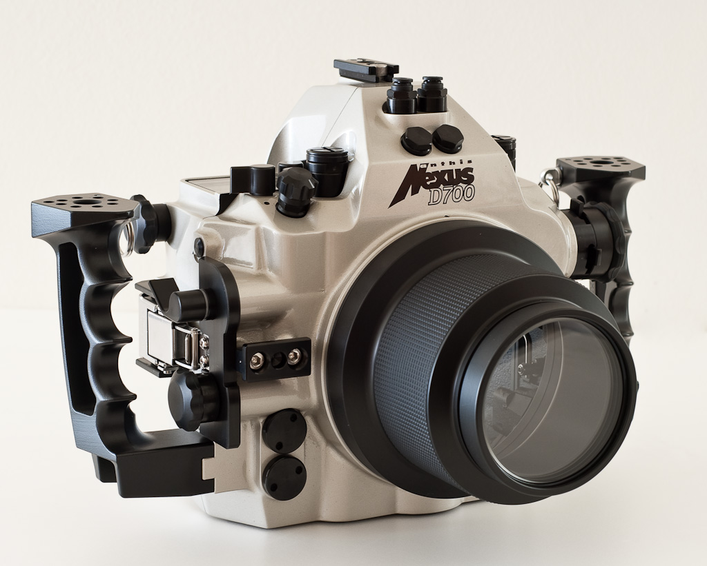

  17. Apparently Nexus Japan has obliged an exclusive dealer in Asia (www.fun-in.com.tw) a run of only 8 white colour (gasp!) housing for the Nikon D700. Other runs is the original champagne silver. Guess the Japs are fascinated with white wetsuits, white fins and white mask and everything white.
    I will post the pictures once I get my hands on them.
    And before anyone label me as a mouthpiece for a commercial shop, let me state officially that I'm not. Just happened to stumble onto the news when I purchased a fisheye port from the dealer for me D90 housing.
    Finally, first Nexus for D700 arrived to Singapore.
    Standard color, Only 2 opto bulkheads were ordered, but 2 more in option.
    Yes, it is M4 size.
    Nice, compact, lightweight.. I am thinking to move from D200 to D700 :)
