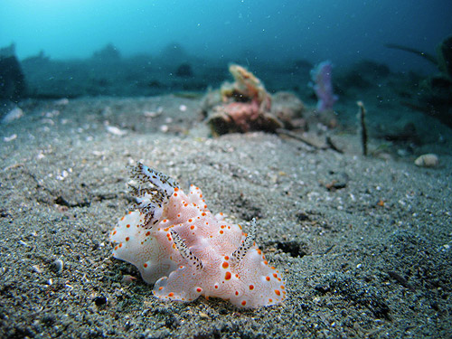

  4. Alex,
    I gave the WA macro thing a go, with my compact ixus, with WA Epoque lens and sinlge Epoque 230 strobe. Was fairly happy with the results. This nudi was basically touching my lens which was rested on the sand. The strobe was almost directly above the nudi pointing down. I think i have the light fairly well balanced for a compact with no manual settings. (1/60th F8.0 ISO 80)
    However in this unadjusted image there seems to be, not backscatter, but it looks like i have focused so close that scratches and dust spots on the lens are visible. Is this strobe positioning?
    p.s first time i have uploaded a photo so hope it works
    Edited by Alex_Mustard
  5. As I wrote in the original articles I wrote on this technique back in 2006, the inspiration actually came from the type of shots I was seeing coming from compact cameras. The motivation was to try and copy them with an SLR.
    The specs in your picture are particles in the water. They can occur in the technique because you are manoeuvring the camera (and yourself) very close to the seabed to take the picture. It is easy to stir a few things up.
    Sometimes they can be stretched into scratch shapes from a little bit of directional camera shake during the photo. Nothing too bad though in your image - certainly not distracting. You could clean them, or leave them in for a less sterile look.
    Alex
