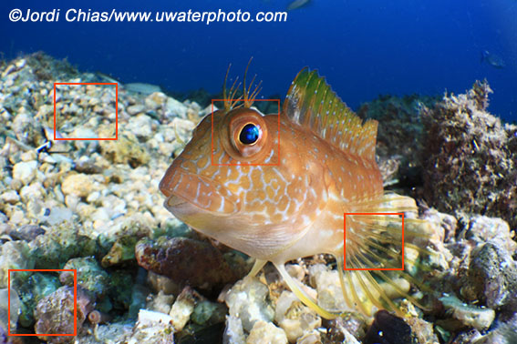

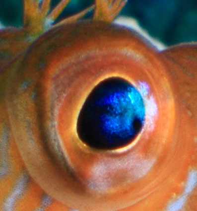

    You are right Alex!! In my opinion, the lens is a special effect lens for special applications.
    For example the depth of field is not as big as it seems. I'll try to post some crops. Focusing is quite critical!
    Sharpness is not as good as a fisheye lens for example. The final image is softer than any normal lens. I've shot at 200 iso in shallow water (without any noise) and when you crop any detail to 100%, it is obvious that is not sharp enough, but anyway the lens is worthy for special applications. From my short experience the focus is better in the center than in the corners.
    I've used a Canon 50D and I tried it with an hugyfot housing and S&S housing with special SAGA port.
    I've tried to use it with the 105Vr+ d300 and the focusing is more critical because of the smaller depth of field. I am not sure if 100mm or 105 mm will have some vignetting in full frame cameras.
    I've tried with the Nikon 60 mm AF-S and there was a lot of vignetting.
    I attach one of the sharpest images that I've got with some crops.
