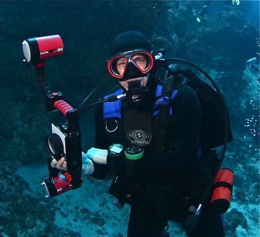

    The Ikelite AF35 Auto Sensor is so good I wish Ikelite made it with a detachable cord touse with DS51 and DS125 / 160/ 161. Also, this latest development of lower mega-pixel Canon G11 and S90 better at ISO 400 and even 800 means MORE flash power isn't necessarily required. Plus the fact I mentioned previously about anything smaller than maybe f6.3 f-stop on little sensors gaining you nothing and maybe hurting detail in your pics.
    Somehow when I post here using what some think is a less capable solution (Ikelite AF35 being one) I sense people think I'm privvy to "special" settings or whatever. Nothing could be further from the truth.....
    I am a lazy UW photographer looking for the fastest, simplest ways to control light from my flash units. I DO shoot a lot to learn how any new camera will react. Plus I know how TTL works and I use that technology to make my images a little lighter, darker, etc.
    Using 2 Ikelite AF35 to shoot the pics posted gave me more than enough lighting power and capability in a very small light package. (Photo of me below with the system and the shot I took in photo #3))
    Happy to answer any questions for anyone using these two new wonders. The Canon G11 and S90!
    dhaas
