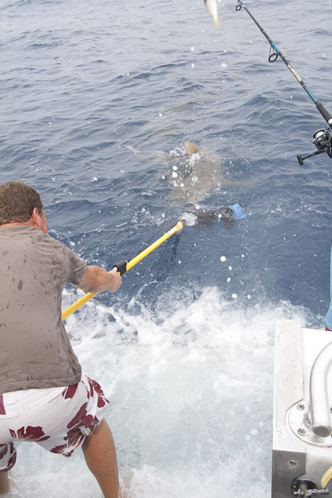

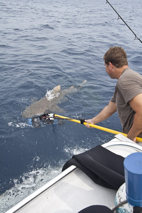

  5. Hey David,
    Might want to take an extra dome with you. Lemons can do some serious damage if your not quite fast enough. Heck of a lot of fun though.
    Here's Mike in action, if you look close you can see how he had the remote rigged.
    Tug of war with a Lemon,
    Good Luck
    Steve

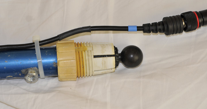

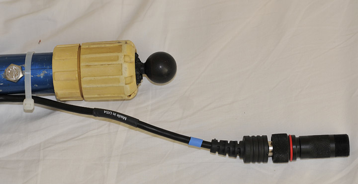

  6. I use it with my Aquatica D300 and it works great . Keep in mind to obtain a dual strobe cable to be able to connect both strobes to a single bulkhead .
    I'm not familiar with Subal so i can not sure about your pin's questions .
    For the pole , i used an extendable pole from a pool net and 1 small tlc arm ( see pics attached ) . I made the tlc arm thicker using electrical tape , also as reinforcement i put 1 bolt trough the pole and the arm section ( tlc arm is perfect for that since it have holes already ) .
    With tie wraps and duct tape i kept the remote shutter attached to the other end of the pole.

  7. Hey David,
    Good Luck
    Steve
    Thanks for rubbing "salt" in my wounds Steve!
    Would you mind sending me some of those tug of war pics for my collection...I had no idea you took those.
    MIke
