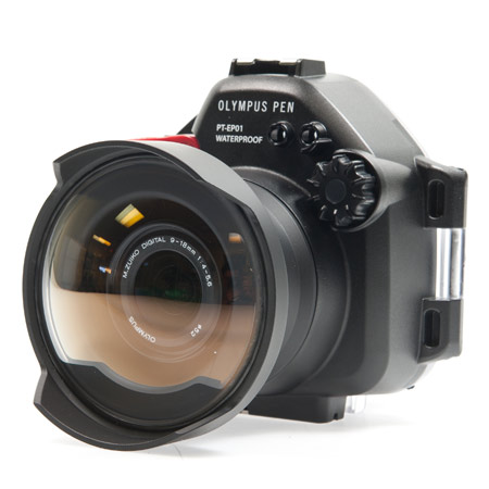

  3. This is a different lens design, not a full hemisphere as is required for full frame fish eye lenses, and there aren't many lenses for conventional dslr that would image well with this dome. It does work extremely well with m4/3, and I expect will work well with other 4/3 and E- mount lenses.
    So this port will not be suitable for the new Panasonic LUMIX G FISHEYE 8mm / F3.5 then, and this micro4/3 FE would require a (new-mount) Zen DP100 instead?

  5. So this port will not be suitable for the new Panasonic LUMIX G FISHEYE 8mm / F3.5 then, and this micro4/3 FE would require a (new-mount) Zen DP100 instead?
    Yes, I expect so. As the 8mm is still not shipping in the US, we have not been able to design a dome for it yet. I am hopeful that our 100mm hemispheric dome used in DP100 will be a good match for that lens.

  7. Yes, I expect so. As the 8mm is still not shipping in the US, we have not been able to design a dome for it yet. I am hopeful that our 100mm hemispheric dome used in DP100 will be a good match for that lens.

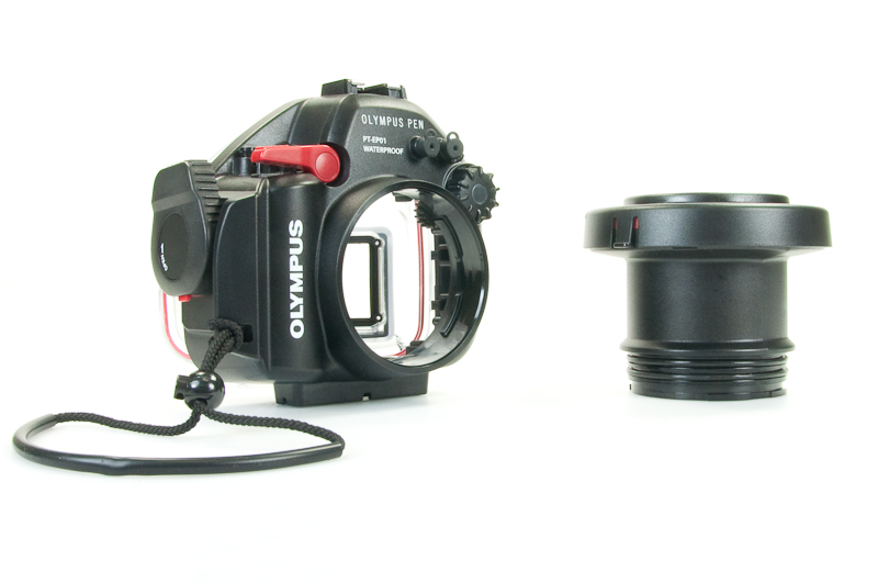

  10. I'm curious. Olympus says the port is not removable. Clearly it is. But is mechanism by which the port is attached to the housing sturdy enough to repeatedly change ports from macro to wide angle? Considering the port was not designed to be changed?
  11. I'm curious. Olympus says the port is not removable. Clearly it is. But is mechanism by which the port is attached to the housing sturdy enough to repeatedly change ports from macro to wide angle? Considering the port was not designed to be changed?
    Clearly this is something that we'd take into account before going through the effort of designing and building an accessory dome. The port mount system is a 90 degree bayonet, similarly rugged to bayonets used in many dslr systems, and those have been proven to be quite reliable over time.
  12. The Athena housing is for the E-P1 & E-P2 different cameras from the E-PL1 camera.
    I own the Athena port addapter which allows for use of existing Athena/Olympus porst and new port that are coming for additional lenses. If you are already an owner of some of these ports for the Olympus, Nexus or SeaTool DSLR cameras this may be a way for you to go. If not the ZEN Underwater PEN port that supports the Olympus 14 to 42 zoom and 9 to 18 zoom lenses is the best way to go. It has a 100 mm coated optical glass port and has great image quality V. compactness.

    So the Zen 100mm port would will work with the the Seatool and my PT-E03 housing? I have the 9-18 and 14-42 lens.
  15. No Manta, that is not what I am talking about. Once again Athena makes an adapter ring that fits the Olympus PT-EP01 housing for the E-PL1 "PEN" camera. With the adapter mounted to the PEN housing ports from Olympus, Inon and Athena made for the Olympus DSLR housings (from Olympus, (SeaTool and Nexus for E-3) can be mounted on the PEN housing.
    The ZEN Underwater Pen port (100 mm) fits only the PEN housing.
    Phil Rudin
  16. No Manta, that is not what I am talking about. Once again Athena makes an adapter ring that fits the Olympus PT-EP01 housing for the E-PL1 "PEN" camera. With the adapter mounted to the PEN housing ports from Olympus, Inon and Athena made for the Olympus DSLR housings (from Olympus, (SeaTool and Nexus for E-3) can be mounted on the PEN housing.
