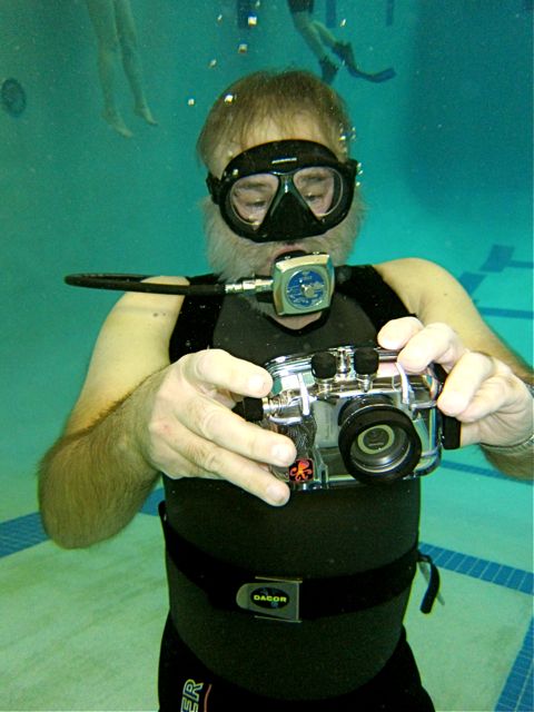

  2. Wow, quite the conundrum. I'm not sure there is a solution for you at the moment as I haven't seen any external lens interface kits for the Canon housing. Are you hard over on not using a strobe for macro? Do you have strobes that you currently use with your wet wide angle lens?
  3. I just delivered another Ikelite Canon S90 housing an hour ago. The newest diffuser for it snaps into a groove farther out on the port. When I showed the customer on how to use macro and shot with just the built in flash the difference in wider coverage was amazing!
    You still can do more with any external flash (like an AF35, virtually non-corded TTL flash control) especially minimizing backscatter, etc.
    But if budget constraints make you use only the built in flash for macro the new diffuser does a nice job.
    dhaas
  4. I would like to be able to mount wet wide angle lenses AND use the internal flash when doing macro.
    You need an external strobe. If you install a wet mount lens it will block the flash considerably.
    Even without a lens attached the large port, which is why you can install the lens BTW (on the Ike), will block the flash, especially up close. This has just been my experience with other similar rigs. Supposedly Inon is developing either an AD or 28AD kit for the Canon DC-35 housing, there is a picture floating around the web:
    There are several reasons not to use an external flash, cost, weight, more stuff to pack, must have a tray and a handle, cannot put it in the BC pocket anymore, Yeah, and, you still need an external strobe, no way around it and with a WAL you might need two. I would rather go back to shooting with flash cubes than do without my Inon D2000.
    Even if the camera flash were not blocked by the WAL lens it's output is no where near sufficient to provide lighting for a WAL lens. Sometimes if you cannot afford the equipment to do what it is you want to do then you should wait until you can rather than waste money getting something that you already know cannot, but other opinions will vary.
