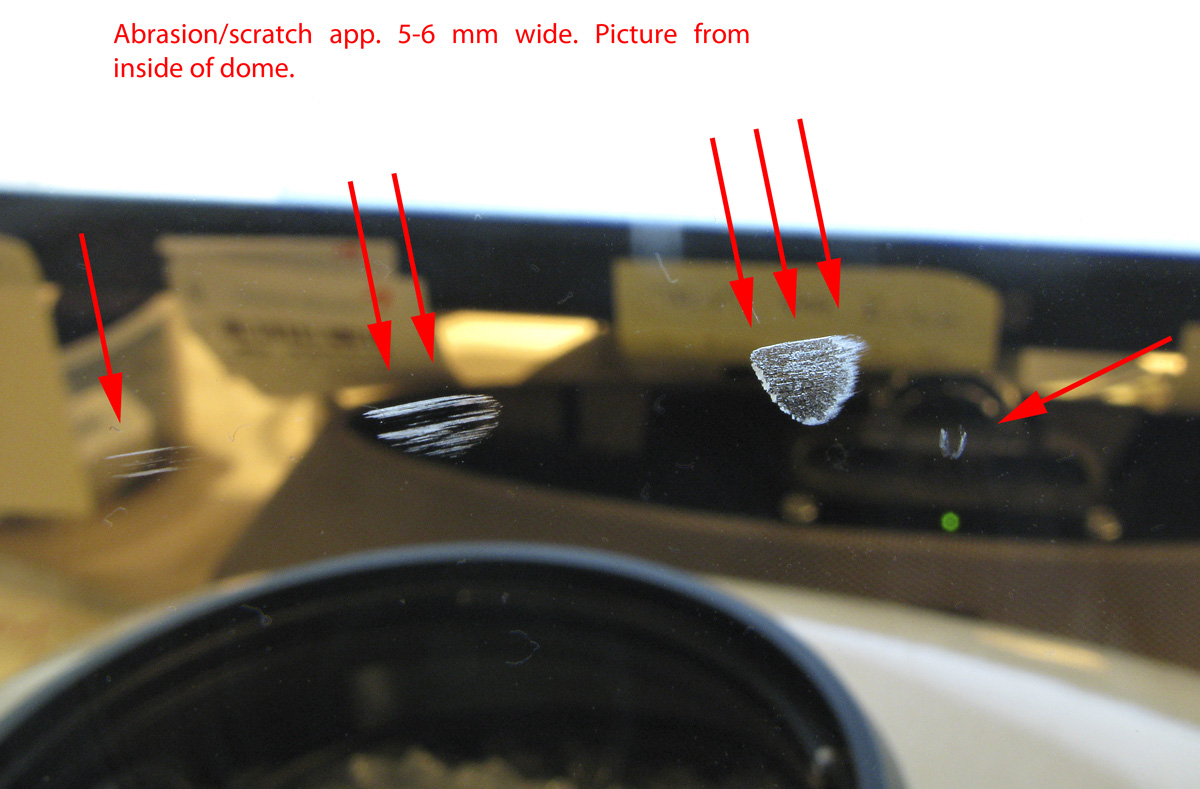

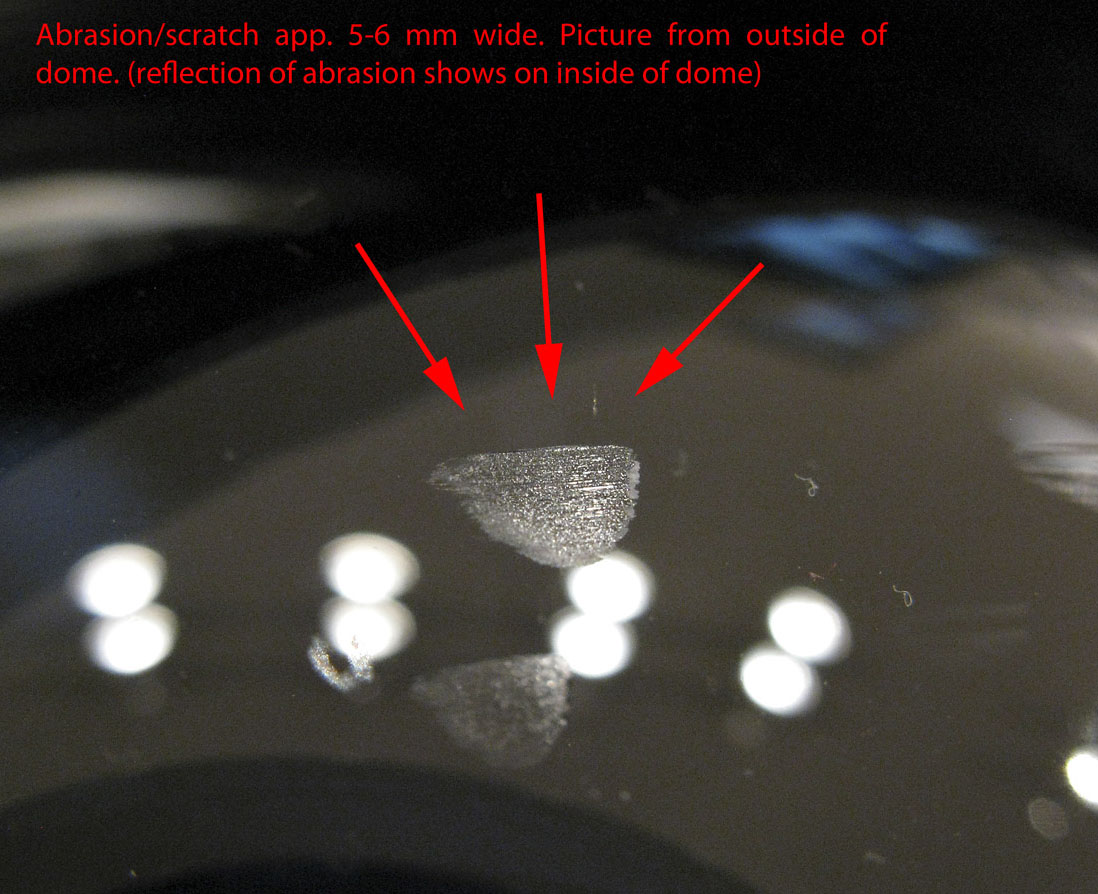

    I have a Subal glass dome with a scratch in it that definitely affects the images more that I can ignore so looking to see if there is any agreed upon DIY approach.
    To be exact it is not as much a scratch as it is an abrasion of what I suspect is the coating. The result is a triangularly shaped rough and matte patch around 5 mm wide. When shooting just a bit against the light, the reflection of the patch shows up in the image as a blurry patch in the image. I can not afford a replacement dome but am willing to try to fix it myself. Or perhaps take it to an optician or someone else. If anyone has good advice let's try to compile it here.
    I read through the amazingly helpful thread on what to do with scratches in acrilyc domes. I found two posts that dealt with glass domes and have taken the liberty to copy-paste them here. I was wondering if the original posters (or others) can tell me more about their final results - I am particularly worried about losing coating once I start this process, though losing the roughed up coating due to the abrasion is probably needed and better than what I have now, I am wondering whether the transition to the unharmed areas of the dome will be smooth and whether the uncoated, but at least polished patch, will show up in images afterwards?

    Here are some images of the worst of the abrasions/scratches on my dome(reflection is of same patch on underside of glass dome):
    Edited by dhphoto

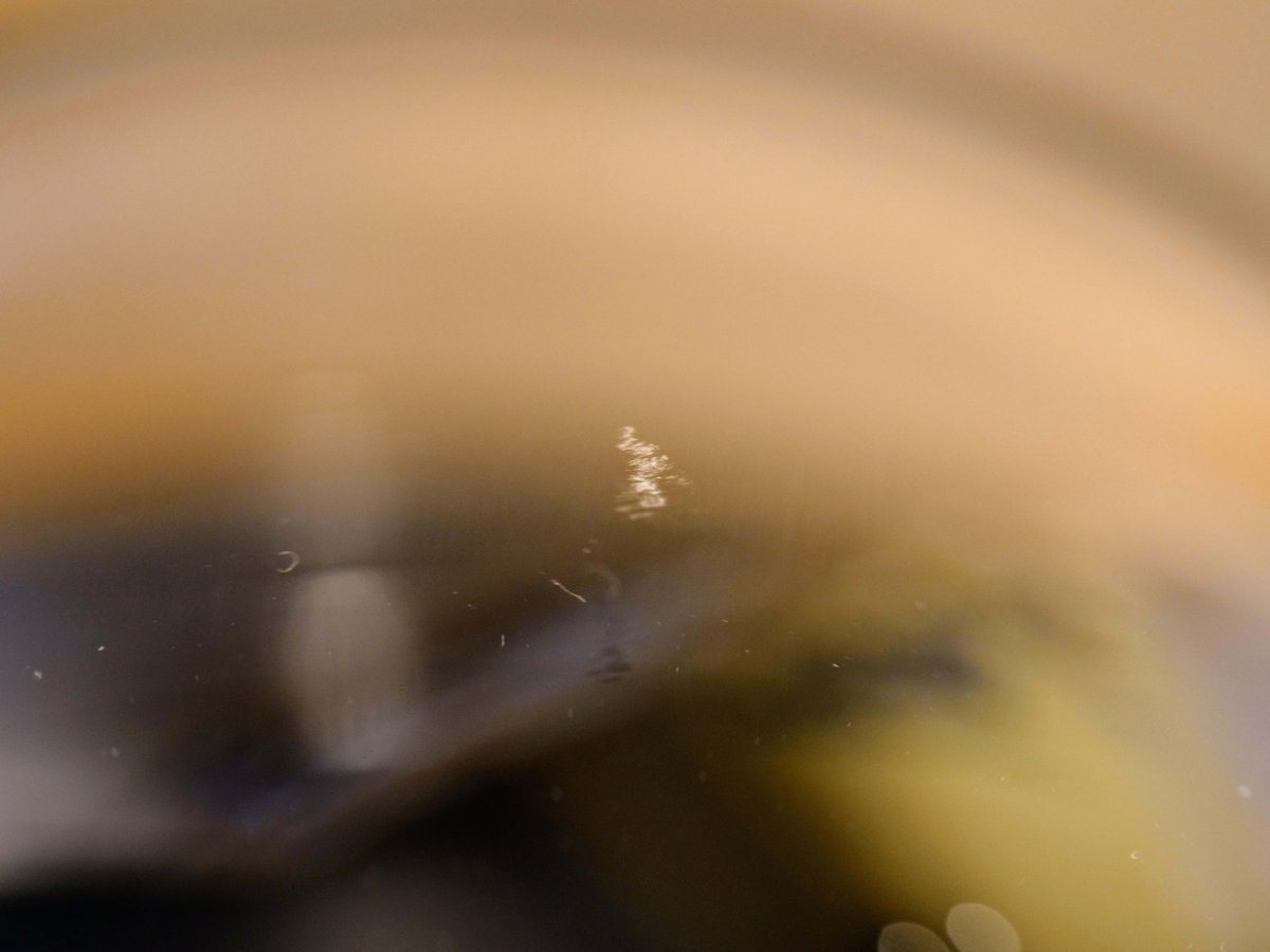

    I have unfortunately suffered an abrasive scratch to the glass dome of my Zen DP-100 thanks to an accident on a boat. See picture attached.
    The result is a dark spot in pictures where light is blocked by the scratch.
    The scratch is barely perceptible by running a finger nail across the surface of the dome. It is approximately 5 mm x 1 mm.
    Has anyone had success with DIY glass dome polishing and repair?
