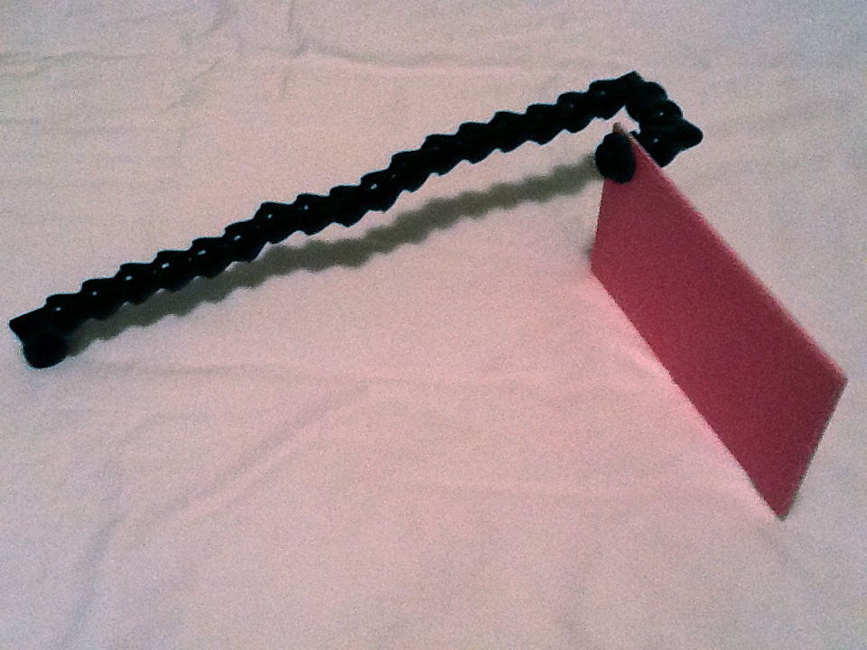

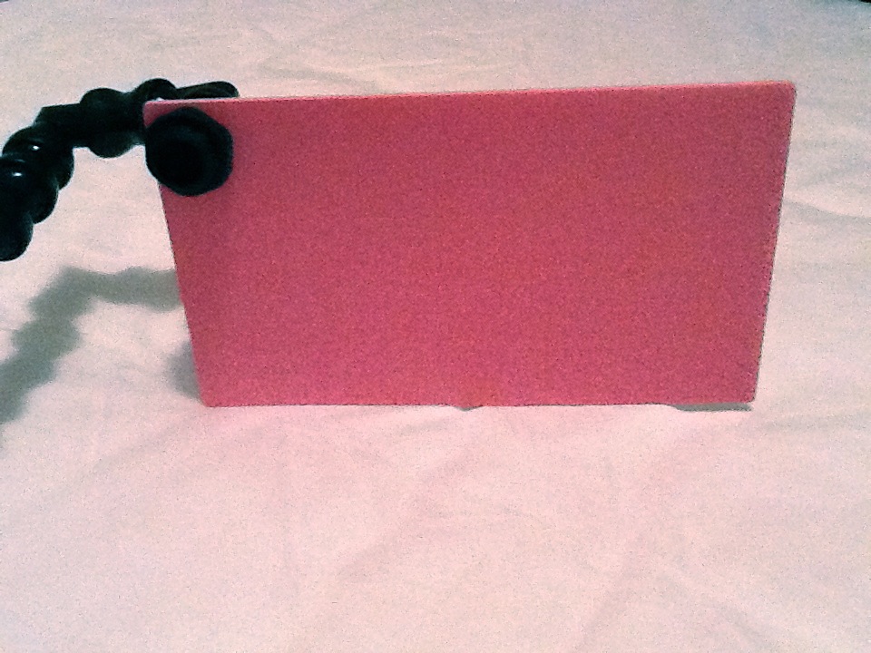

    Hi John,
    I reckon that for the CX550, you want that "grey card" to be a pink / white card. I made a slate on a flexible arm for MWB. The slate is just a diver's slate cut to about 20cm x 12cm (close to 16:9). I spray-painted one side matt pink and the other side matt white. The arm is made out of locline about 35cm long. I used a couple of locline corners and a locline nut/blot to mount the card. The photo's attached here a just simple iPhone photos but you can see enough to get the point. To mount on the L&M housing, you'll need a locline "Y" piece on the bottom of one of the lighting mounts. On the boat, the slate folds back above the housing. Underwater, when not used, the slate folds back under the housing.
    With the CX550, the white side works down to about 5-8m, depending on conditions and the pink side works best deeper. Use lights partially or fully on the slate to "tone-down" the CX550's problem with the red-fuzzies. When using the slate to MWB, I suggest that don't use the red-filter or any WB shift settings. Just play with the slate, lights and MWB until you get a good colour balance on the monitor.
    You can mix white and red paints to get the right shade pink.
    Regards
    Peter

  5. Clearly Peter, you need to practice your MWB with the iPhone...
    Unless of course your sofa is pink!
  6. Clearly Peter, you need to practice your MWB with the iPhone...
    The bed cover is white but the room has very warm lighting.
