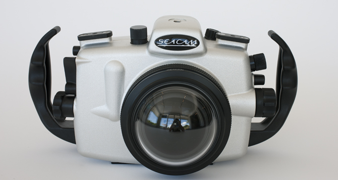

  17. I just received the new Seacam fisheye macro port, now available with or without sunshades to be able to use with Canon 8-15mm lens on a full frame camera like 5DMKII or 1DsMKIII without vignetting. Cant wait to try it next week in Bonaire!

    From the reflection in the dome it looks like it is sunnier in the key's than in Monterey :) t'was nice seeing you Sir!
