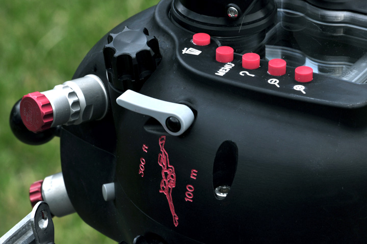

    The housing comes with access to all controls but: Shooting mode selection (S-Cl-Ch...), BKT button, Fn button and L lever. All useless to me except, maybe, the shooting mode selection. What I do is dive in Cl mode with only one shot per second and, if I want action shooting, I just dial up to 2,3,4 or 5 fps in the menu... easy fix.
    Externally, the housing comes with a port dust cup, the functions are engraved (not painted) and it also has the top window. The main back window is big enough to see the screen completely and the hugycheck bottom leds. This back window is were the viewfinder is located (I will not comment on the viewfinder as I have never used it) and it is very easy to swap it with one of the inon viewfinders I already own. The bottom of the housing comes a tripod screw.

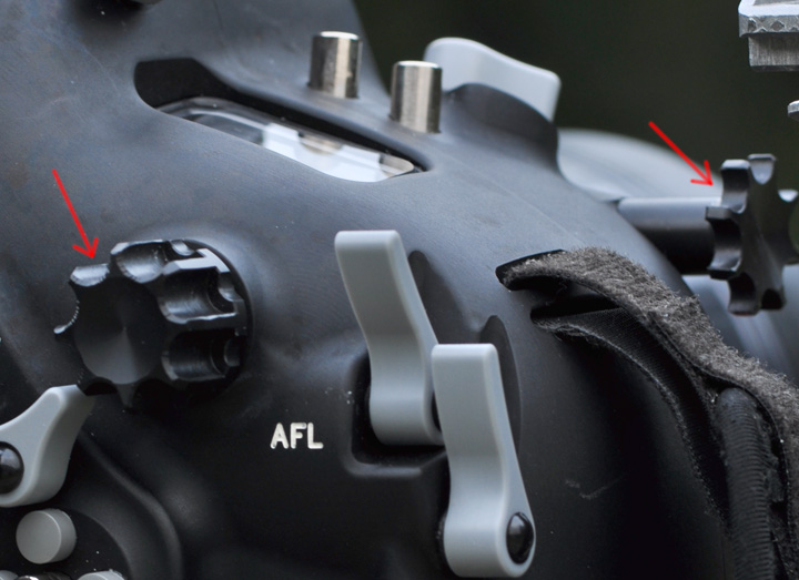

    Just went on a 14 days liveaboard Maldives trip with this Hugyfot D7000 housing after adapting a few things before i left :D, 33 dives and no problems at all.
    That is my solution for improving Alex his remark. Now i can control them with one finger because off the bigger edges in the dials!

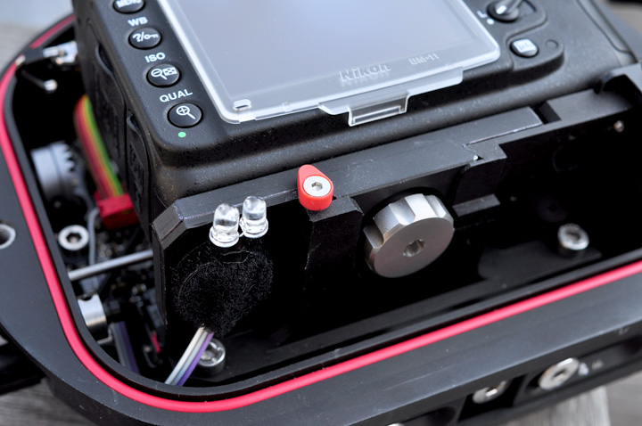

    And off coarse the new camera slide!

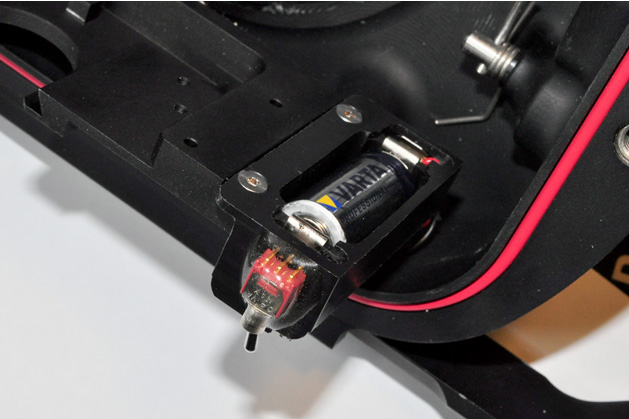

    Also put a switch to turn off the battery if not needed.
