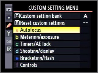

    In Nikon-speak, "C" is continuous autofocus: on my D300s it's set with a small 3-way switch at the lower left of the lens-mounting plate.
    "Focus priority" is a menu setting under the Custom Setting Menu, section a1. The combined effect is allow the camera to fire as soon as you depress the shutter, but to force the camera to optimise focus, rather than ignore it completely, as it does in "release" priority.
    What this achieves with the 105mm is the ability to track the subject through the viewfinder, be able to take the image at the "peak of the action", but use AF so that you can concentrate on composition and the animal rather than on the focus.
    The other main technique is to preset manual focus "M" on the 3-way switch, and move the camera to get a sharp image, so that there is no delay from the camera. Although there is a control on my Nauticam housing, there wasn't one on my previous Nexus housing, and the focus mode had to be preset before the dive.

  13. In Nikon-speak, "C" is continuous autofocus: on my D300s it's set with a small 3-way switch at the lower left of the lens-mounting plate.
    I'll look when I get home, but I'm pretty sure on my D90 it's just a 2 way switch, A-M.
    I'll take a real hard look at this, sounds like I might be on shutter release priority at present.
    Here again, I need to check my selector switch and see if it's a 3 way. What your describing should be able to be accomplished by just utilizing focus lock yes?

    Greg,
    Set you AF/M switch to AF and then depress the AF (mode) button on the top of the camera. With the button depressed, dial in the mode.
    Bob
  15. Thanks Bob, so when dialing the mode, I want AF-S? Also, I have an issue with my Cam in general. When I got it, I'd hit the shutter and it was an instantaneous "Click..Click" I had to send it back to Nikon when the actual shutter button fell off. They replaced the whole triggering assembly. Now, when I depress the shutter I get a "Click.........click" with quite the delay. Everything seems correct as far as shutterspeed and exposure. Is this some kind of setting that was changed by them when they replaced it? Just kind of seems weird.
  16. Thanks Bob, so when dialing the mode, I want AF-S?
    You want AF-C (for continuous). With AF-C, when you half depress the shutter button the lens will continue to focus while you or the subject moves, until you fully depress the button. With AF-S, it will only focus a single time when you half depress the shutter button. You'd have to release and half press again for it to focus again.
  17. You want AF-C (for continuous). With AF-C, when you half depress the shutter button the lens will continue to focus while you or the subject moves, until you fully depress the button. With AF-S, it will only focus a single time when you half depress the shutter button. You'd have to release and half press again for it to focus again.
