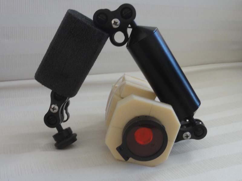

    Inspired by this thread by wydeangle, I decided to solve one of the problems I have, which is that the Big Blue VL1300 lights, as nice as they are for video, are negatively buoyant and therefore tend to make light adjustment (especially forward) quite a challenge for my arms. Just as a reminder, here is a photo of my current setup.

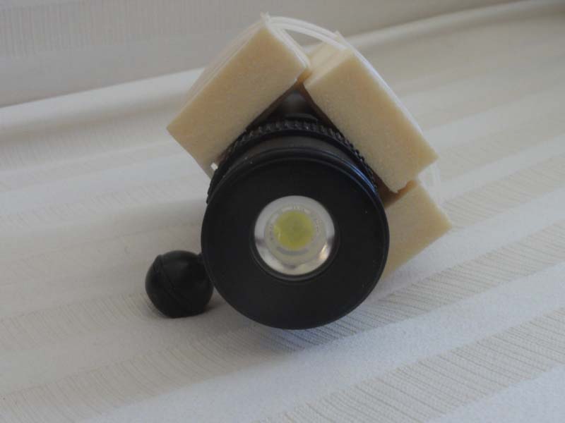

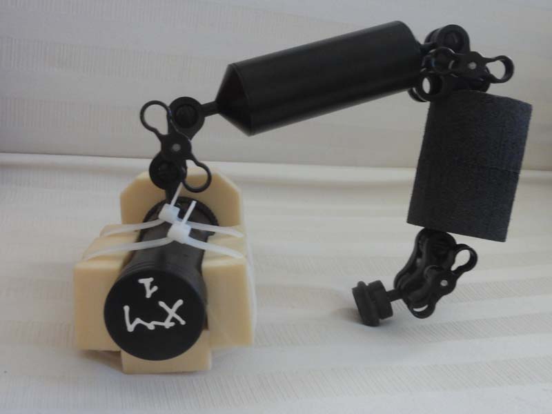

    The final result looks like this:

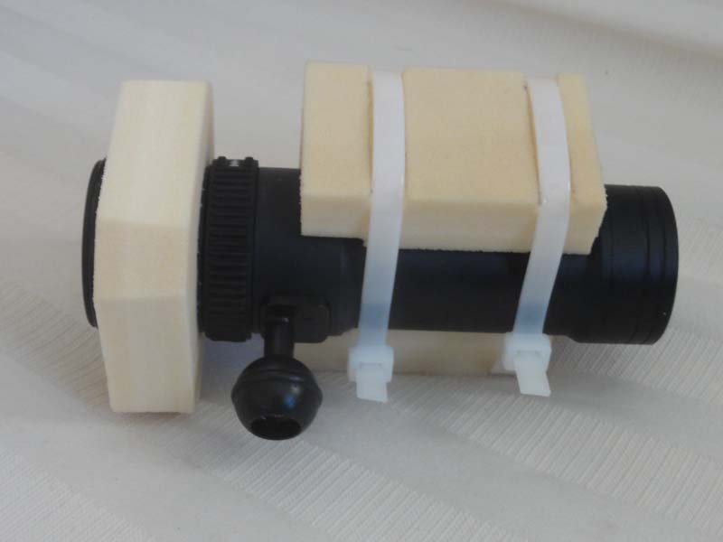

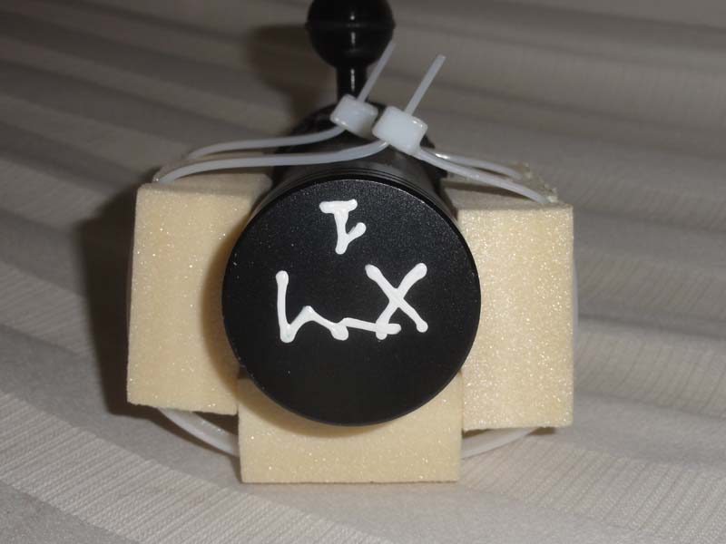

  2. Design of the main body floats.

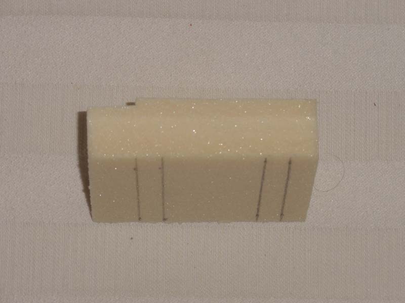

    I cut out 3 identical parts from one corner of the 1x10x12" foam block using a hack saw:
    The line 11/16 from the top defines where the block will be slightly carved to account for the wider diameter of the head (The blocks will stop just before the rear part of the body widens):

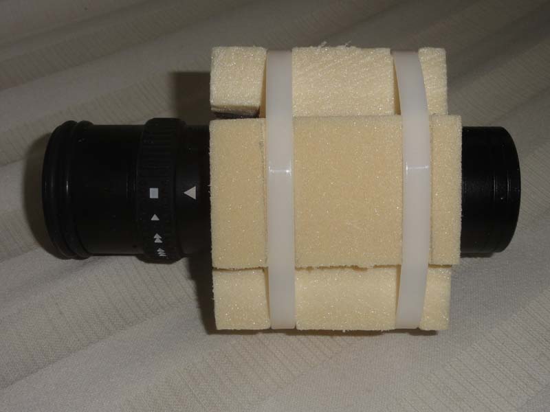

    On the outer part, I defined two 3/16 wide shallow grooves for the two cables ties which will hold the foam blocks together. I used 24" long cable ties ($5 for 10 at Home Depot). I carved the edges of the grooves using a knife. This foam is very easy to work with.
    The assembled parts look like this:
    As you can see, there is good access to all the parts I mentioned in the introduction.
    The 3 blocks rotate as a whole around the light (over ~ 30 degrees) if needed, but they are not freely roaming around (the cable ties are tightened).

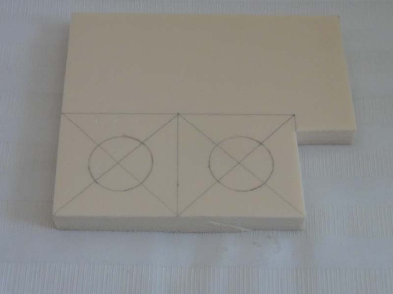

  3. Design of the front float.
    I did not have much choice for the front float, since I needed to be able to unscrew the light head (to recharge it), and as far as possible still be able to slide in the red filter I use as a protection for the lens when not diving. After some sighs at the idea of having to cut out such a part, I went ahead and decided for a 4x4" square slid around the head:
    I just used followed the contour of the head to draw those circles, and yes, I know, they are not centered...

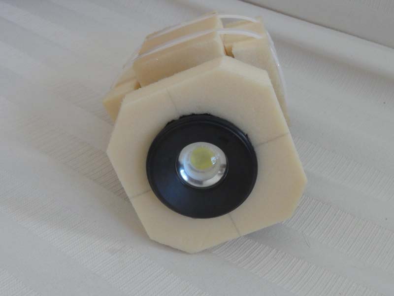

    Anyhow, after some efforts with the knife (again this is a relatively easy job, although you need to be careful not to cut yourself) and a hack saw blade to get smooth edges, I manage to force fit the head part and use the float to screw it back on the main body. A quick test showed that the light thus equipped was now too buoyant (in fresh water) so I sawed of the corners to get an octagon:
    As shown in the first post, the filter fits nicely in the front (I forgot to mention that I had to remove one of the external O-ring, which play no obvious role, except for the first one, which helps holding the filter in place).
    I still need to test this contraption in salt water and possibly adjust the size of the front float, but since my Fathom lens makes the housing negatively buoyant, that may not be necessary.

  6. Uwxplorer,
    Well done!
    If you don't mind a small suggestion, I'd recommend putting the zip tie buckles at a corner so they don't present a snag point.
    I predict you'll enjoy the results!

  7. If you don't mind a small suggestion, I'd recommend putting the zip tie buckles at a corner so they don't present a snag point.
    Good point. I actually cut them shorter. I don't think they will be more of an annoyance than the lights themselves, which I have to watch carefully when navigating through the kelp forest...
  8. Late update on this system: I eventually discarded the ring-shaped parts I had so painstakingly carved out, as my rig was too buoyant with them. Other than that, this works like a charm.
