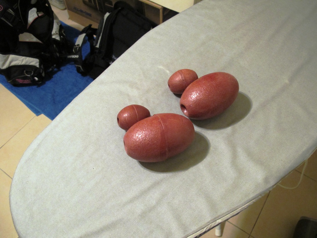

  12. Must be the Dutch blood in me however whilst they are effective I find stix floats pretty expensive for what it is...Therefore I picked up a hand full of these from a tackle shop for next to nothing. They are made from a very hard foam, however I have not had the chance to take one underwater yet. On the off chance has anyone tried it before I get the kitchen dirty???
    Anyhow, if it works I will start selling them here branded as AntiBrix floats, and will paint them any colour you like!!! :)
