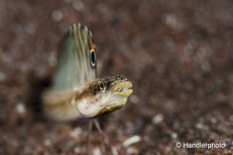

  5. Click on the link by the OP. Mauricio Handler took the 1st unit down for a dive and has sample images.
    S.
  6. geez that was quick Stewart! Are you referring to the blenny photo?
    Unless Ive missed something out of the AQ site Id like to see a few more examples of different supermacro critter closeups?
  7. @Stewart, which link were you referring to? I'd love to see the image samples.
  8. There are sample blenny images shot by Mauricio Handler in the Aquatica website. The close up kit is only just arriving in dealer's shelves so images taken with them should be coming.

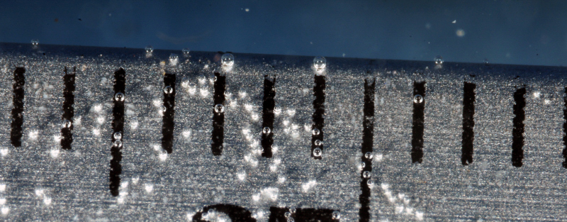

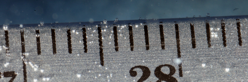

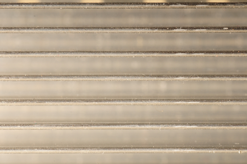

  11. What I have is basically rulers and textures aluminum, not really exciting at all, there is a shot of a Sailfin Blenny taken by Mauricio with the +5
    I dug out some of the boring stuff from the hard drive, be forewarned, these are not high on the emotional stimulating factor. :drink:
    first the +5
    and the +10
    The ruler was positioned at an angle in order to have an idea of the depth of field, and aperture was f/40 for the +5 and f/45 for the +10, the grid was shot at f/18 with the +5. I will limit my comments to this.
