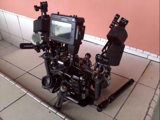

    Note to future DP4 monitor buyer (Canon user):
    I know somebody already mention this on article but...
    If you want use DP4 with Canon 7D or 5DMK2/3, ask them (SmallHD) you want modded DP4 for 7D.
    When I just purchased monitor last Feb, my 7D often felt to Error 80 (locks up the camera. MUST pull battery to reset.) if I forgot to turn on camera first then monitor.
    And other problem, camera's lcd is always off when dp4 connected via hdmi cable(If dp4's battery going out then you're blind).
    It happend few times underwater and I forced back to the boat when I was in Ambon/Lembeh last Mar.
    After trip, I sent it back to SmallHD and they quickly send me "modded DP4 for 7D"(it's doesn't have problem and works even better w/ 5dmk3 then standard version).

    Hy, I have the same problem with mine DP4. They told me that it is Canons issue and that they cant do anything about it! What did they modded on DP4? mine works always if I first start camera then monitor. Always before dive I need to start camera then monitor and finaly attach HDMI cable to camera and close housing.. It is pain in the %&/!
  14. Alexx, tell them you‘re using it underwater. I missed some really nice behavior scene because camera locked up. Now I can comfortably on/off monitor and camera underwater for conservation battery.

  18. The newer version of DP4 doesn't have this problem.
    Recently, I order another one for my friend and this is what I got from their support dept.
    "All of our DP4's now* come with that mod so you are good to go".
