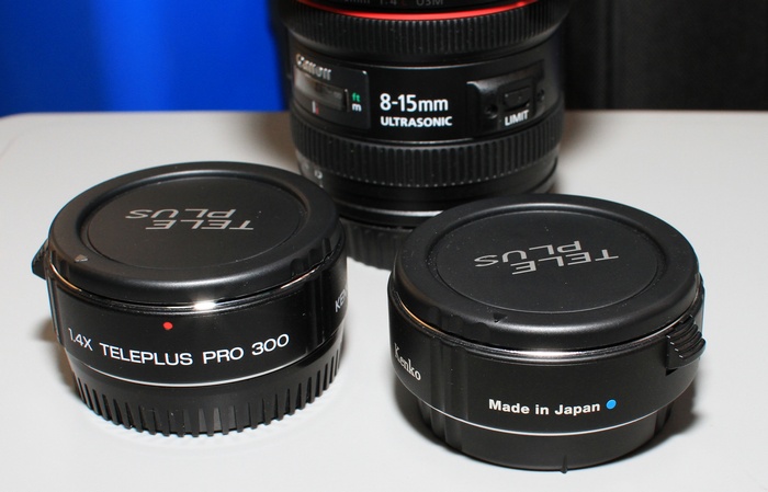

    Kenko DG AF PRO300 (older model) is often fail to lock focus with 8-15mm but DGX (newer) is working nicely.
    Looking for Kenko PRO 300 AF DGX 1.4 with blue dot.
    And it's working with Canon 100mm IS L as well (DG working only with 100mm non-is).
    Edited by escape
  17. Interestingly, my C-AF 1.4x Teleplus Pro 300 DGX is marked with a red dot. So this morning I called Intro 2020, the UK importers of Kenko products, who advise that the colour of the dots does not denote any specification difference and are unaware that there could be a colour difference.
    My 'red dot' does work with the Canon 100mm IS L on either the 7D or 5D3. Naturally the 100mm grabs focus quicker when the focus range is set to 0.3-0.5 m and with only minor hunting. So I expect it'll work OK with the 8-15mm which is a planned future purchase.

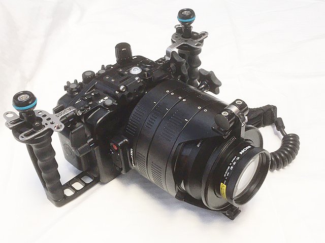

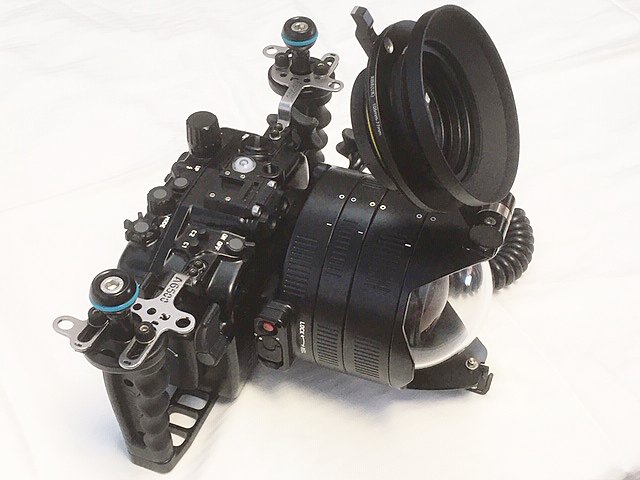

  18. I recently added the Canon 8-15 to my Sony a6500 APS-C rig.  I'm using a Metabones IV (latest FW) and  blue dot Kenko 1.4TC . The Canon by itself, or with the Kenko, focus quickly and accurately, even in low light. The configurations are able to track and focus in video mode as well.  Plus, I can keep Peak Focusing on in both still and video modes with MB latest FW which I love on the a6500 rig's tilted view screen. I attribute this to the improvements in MB FW.
    For a port, I use a modified 4.33 FE with a 67mm macro swing mount (from Port 72) grafted onto it's shade wings.  I can now shoot a wide variety of lens with just two extensions (20+30 N120) and a 50mm N85 to N120 adapter with focus knob and the 4.33 port. They include the Canon 8-15,  Zeiss 12 Touit,  Zeiss 16-70 (single dive still and video lens for WA and M using diopters), Sigma 16 f1.4,  and Sony 90M.  With the Canon FE, I no longer really need the Z12 and S16, but they still have their place for a WA rectilinear and fast video lens. However,, since I want this as a travel rig, I'll most likely will sell the modified Z12 and S16 f1.4 (both work in N85). In addition, the Z16-70 works great for moderate WA and M at it's 70mm end (with Inon diopters) so the heavy S90M may sit at home on longer trips.
    My tests so far are mostly surface tests,  but I expect them to work well once I get back to diving when this COVID pandemic lifts and I feel safer traveling by air. However,  I've used  the Z12 (modified to fit N85) before in a N85 4.33 with pretty sharp corners while diving, so I'm sure the sharp C8-15L will excel in the N120 4.33 dome. Unlike FF where you basically have either a usable 8mm circular image or 15mm FOV, the cropped sensor and Kenko give the a6500 a 10-21mm zoom range.  It's a very nice CFWA lens setup.
     if you need any info on this set-up, please send me a PM.

  20. Yes, I agree, you are correct in your assessments.  I almost bought a 140mm from a friend, as it's a premier glass dome with coatings, no doubt a beautiful port. I use the 4.33 port over the 140mm due to my grafting a 67mm swing mount onto it's shades.  It simply allows me the ability to use all the lens I prior mentioned with the one port, something I can't do with the 140mm.  Besides, I had this swing mount set-up on my N85 4.33, so it was rather easy switching it over to the same size N120 4.33.  As much as I wanted the 140mm, i determined it too difficult to re-engineer my custom swing mount to it's shades.  These were the main reasons I stayed with the 4.33. It had nothing to do with weight or size.
    I would like to add to the original questions regarding the post topic: While focus is accurate using the Kenko 1.4 (mine is a blue dot) and Metabones IV combination (latest FW even in low light) I noticed I often have to hit the focus button twice to get an accurate focus (as defined by Peak Focus highlights) for some reason?  The 1st push sometimes knocks it out and the 2nd brings it back in focus? It's quite consistent and might have something to do with the firmware on the MB? It mostly seems to happen when I'm not doing CFWA.  I haven't tested whether this happens with the C10-18 by itself. I also haven't tried it using the AE/AF/MF back button as my focus activation button, rather than the half shutter standard method, which is how I want my Nauticam a6500 housing set up. As soon as I get a chance to set up the back button focus method, I'll update the post, along with some underwater tests.
