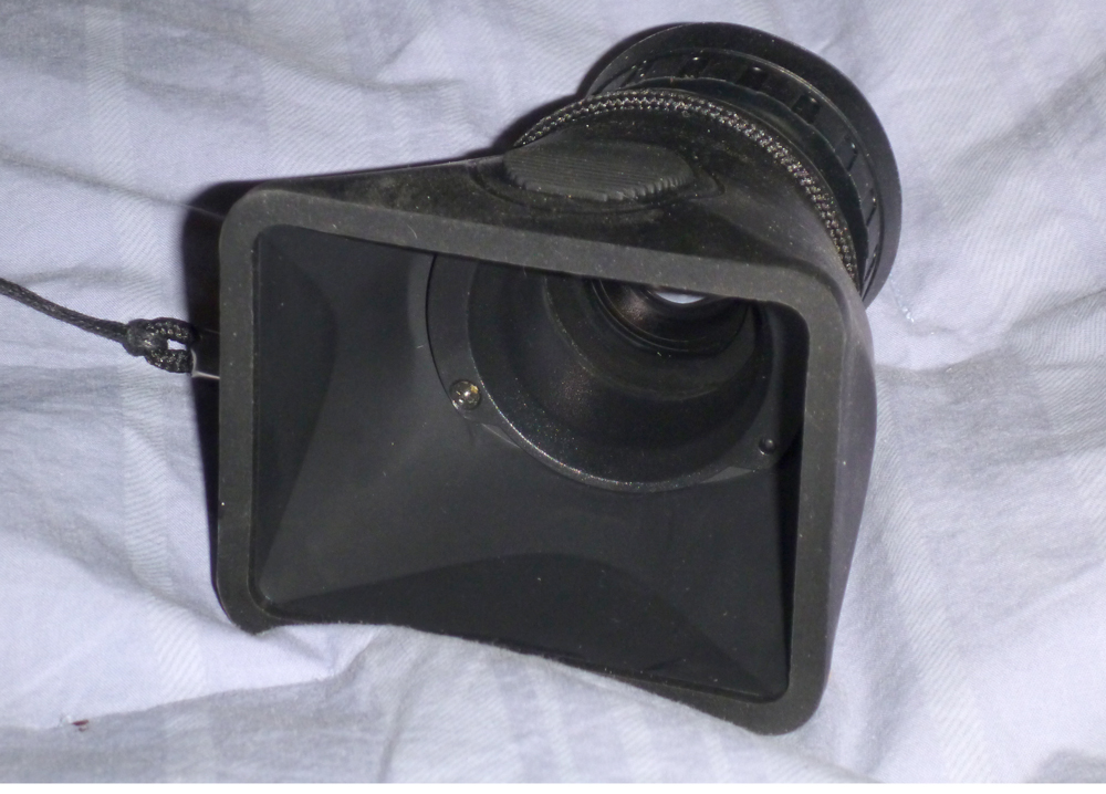

    The LCD on my Nauticam was very easy to use and frame photos. If it becomes a problem is very bright and shallow water then use one of these (79$)
    It covers the LCD almost perfectly. I just need to get some velcro that will attach to the housing. Hopefully future housings will incorporate a shade on the top part. I have seen many inexpensive housing with this feature.
