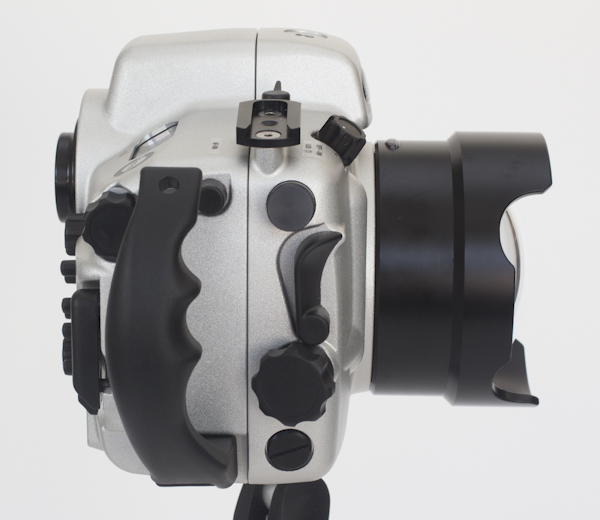

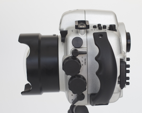

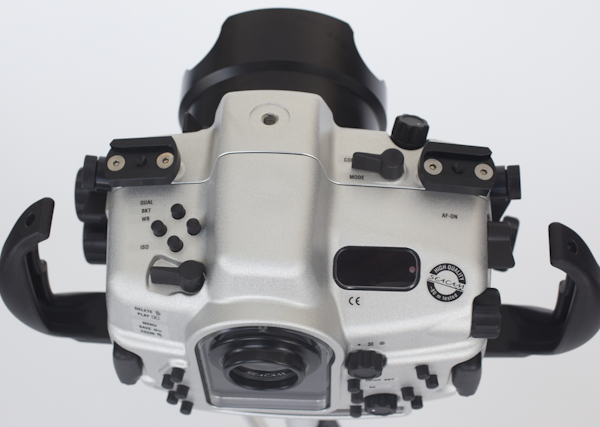

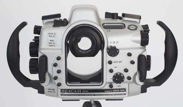

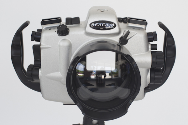

    It is appropriate that the first D800 to arrive in the USA belongs to Mary Lou Reid, who began this thread on the SEACAM D800. So, before it relocates to Texas, and then the world of her favorite critter destinations, I shot some photos of her housing today.
    Here are the exteriors:

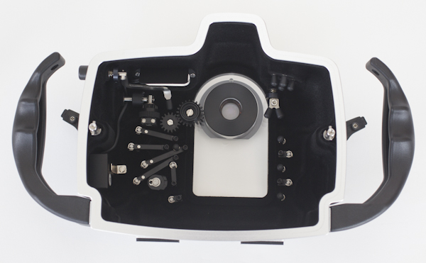

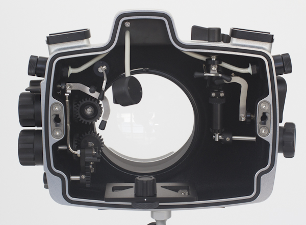

  17. Here are the interiors:
    For those who inquired about the AF/MF functionality, lift the external lens release lever up and it releases the lens so you don't have to open the back of the housing to change lenses:
    But, press the same control down and it pushes the little button that is built into the AF/MF control:

  18. Steve,
    Thanks for posting, Looks very nice.
  19. It looks good!. I see there is room for the camera´s flash but no OF connector; is it user´s choice?
    Is that a third connector plug on the bottom right of the housing?
  20. Hi David,
    I had my D300 altered by Michael Finger ( www.mike-dive.de). He used the third connector plug to make a connection for my opitcally triggered Sea&Sea flashes to the internal D300 flash, works perfekt. He will do the same for my D800 housing.
    Rob
