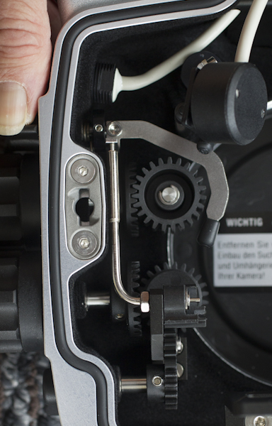

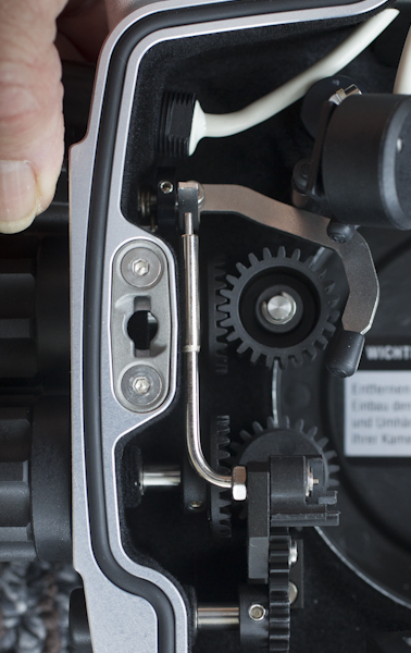

  2. Sorry ... for whatever reason I couldn't quite get the right two photos to appear to show how the dual functionality of the lens release lever works. To clarify:
    Here are the interiors:
    For those who inquired about the AF/MF functionality, lift the external lens release lever up and it releases the lens so you don't have to open the back of the housing to change lenses:
    But, press the same control down and it pushes the little button that is built into the AF/MF control:
  3. Stephen,
    This dual-use control looks like a very nice solution to this complex D800 camera control. Do you keep a "demo" D800 housing at your shop? If so, I'd be interested in coming down to handle it with a D800 inside. I can bring a D800 with me for the purpose. While some people may have interpreted some of my comments as being anti-Seacam, they also need to look at the favorable things I have also said. I feel that legitimate criticism should have the possibility of leading to improvements. As as Stephen knows, I modified most of my own ports and extension rings to have the double O-ring system that is now standard, many years later, on the ports and extension rings that Seacam now produces. I did this in 2001 and showed it to Harald and Stephen at the 2001 DEMA show. That was when I was shooting with the Seacam F5 housings.
    To Adam, et al. I have been out of touch for the last three weeks since offering to show pictures of my D700 housing modifications. At that time I was in Bali, and a day or two later my laptop computer died consigning me to internet cafes for the remained of that trip. I've made it back to Sarasota and have just replaced the dead laptop with a new one. And hope to be able to participate in D800 and D800 housing discussions, which are very relevant to my own photographic interests.
    Fred

    Sorry, Fred. We don't have a demo housing for the D800 at the moment. If we did I'd be happy to have you dive it. For now all our housings are committed to shooters with upcoming travel, so we are trying to expedite their deliveries.

  14. Hello Stephen, et al,
    I've just had the opportunity to take a close look at one of Seacam's D800 housings. I feel it is an excellent housing for the Nikon D800 camera and a considerable improvement over my D700 housings. It now has almost every control you could reasonably want, except perhaps a port lock, which I will be able to add since it is important in my opinion. The change in position of the AF-M switch from the front of the housing to the lower left side makes it easier to reach with your hand on the left hand grip. Making what was only a lens release lever on my D700 housing do double duty to also push the small button on AF-M switch of the camera has been done very well. And again, this control is easily used with your hand in place on the hand grip. There is also now a control that allows you to switch between spot, matrix and center weight metering. I don't use the matrix metering with any frequency, but I do use spot and center weight metering regularly. This control now allows me to make the switch underwater and not have to choose one or the other before the dive. Internally several of the controls have been redesigned and beefed up. And, to me, they look more reliable. I commend Seacam on these improvements.
    Fred
