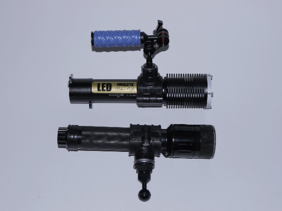

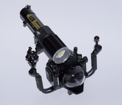

    Here's a couple of photos. The first shows the size relative to the current production LED 4000. The LED 9000 is about 300g heavier because of it's all aluminium construction and bigger battery. Both are tested to 100m. In both units the head unscrews to allow quick battery swap and/or charging.
    The second photo shows the handle removed and fitted to the Nauticam GH2. In real-world use there would be a reasonably long arm (I use the floaty type) between it and the housing.
    There is an attachment point at the rear to allow two lights to be easily coupled together (with a special bracket) for 18,000 Lumens.
    The one hour burn time @ 9000 Lumens is due to a state-of-the-art 5 AH Lithium battery. My aversion to Lithium batteries is mellowing after using this design which has sophisticated protection circuitry built in...and has behaved very well so far. smile.png
