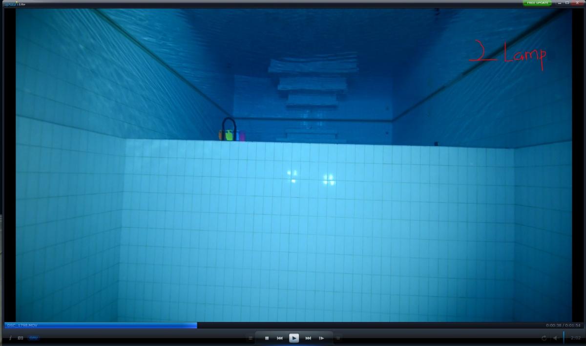

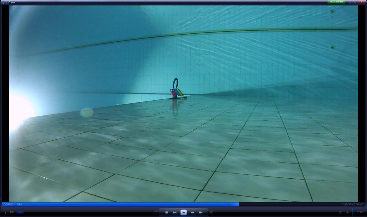

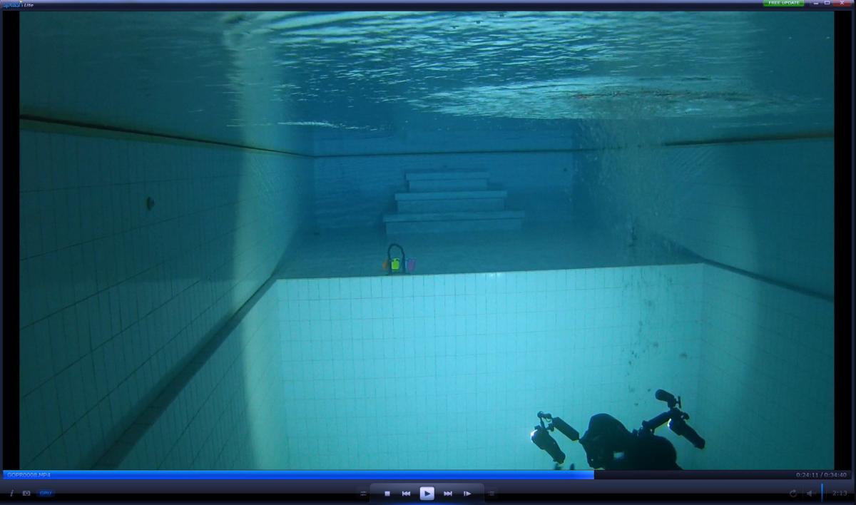

    In your "Capo D'Acqua: a short tale" it looks like your model was using two LED lights together in tandem?
    Yes, we sort it out with what available at the moment. We had a couple of poor's man Darkbuster HID 21W Video lights. We taped them together for handheld use.

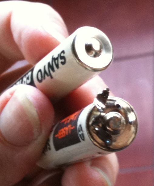

    I learned my lesson the hard way when I was building HID video lights and during a trip to China was given a "great deal" in order to change the NiMH 14.4v packs that I sourced from China. The factory looked OK (I was in the Ningbo industrial zone to source Ballasts). They looked very well made...on the outside. Too good to be true.
    During testing back in Australia one pack exploded like a small grenade. No real harm done as I only ever charge batteries (ANY batteries) when I'm around to keep an eye on them...but I was cleaning the room for several days to get rid of the black residue off the walls and ceiling. Had they been Lithium (which burns like a Magnesium flare) I would have probably lost the house.
    Could be worse...a German dive buddy who is a Medico once showed me some photos of a German cave diver's pulped hand (no fingers left) when his DIY high powered light exploded underwater. That image has always stuck in my mind. I have the greatest respect for what high capacity batteries can do when they go wrong.smile.png

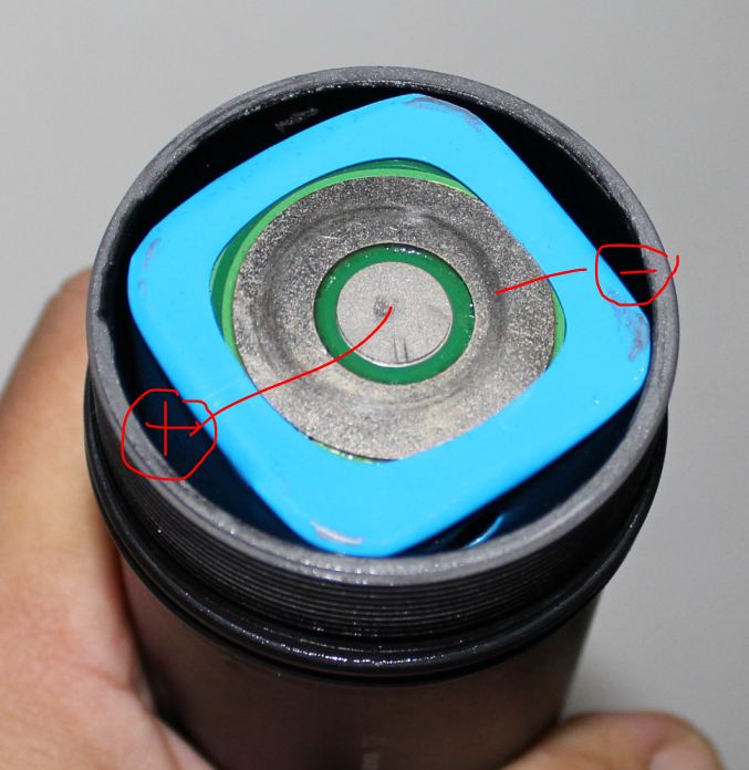

  14. Hi Davide,

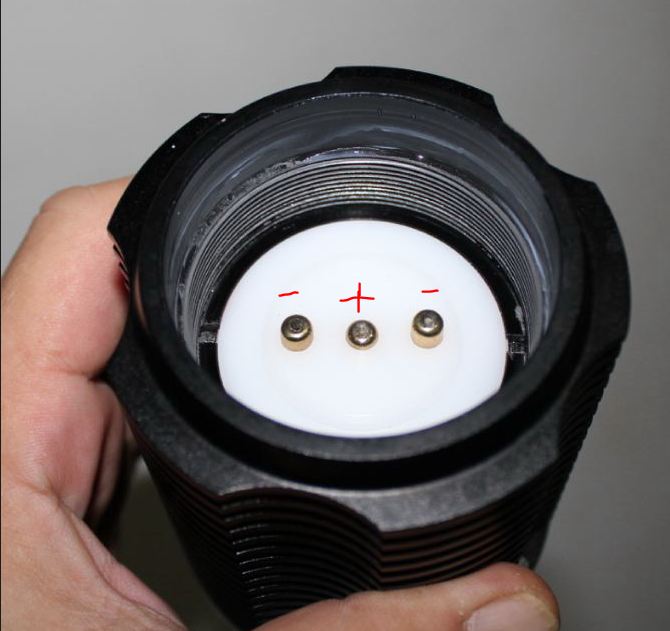

    See the photos.
    The battery pack terminals, the + and (-) is too close. This they got to do because they use a spin-to-ON design and not wanting the torch barrel to carry negative electric flow. The barrel not being an electrical conductor is good but spacing of + and (-) terminals that close and for a battery one need to charge outside the torch, that is dangerous. By accident, any 5mm or bigger metal ( example a coin, a paper clip ) object touching the two battery terminals will "weld" that metal due to the potential energy this battery pack has. The battery pack should come with a safety plastic cap for during storage and charging. NOPE there is no safety cap.

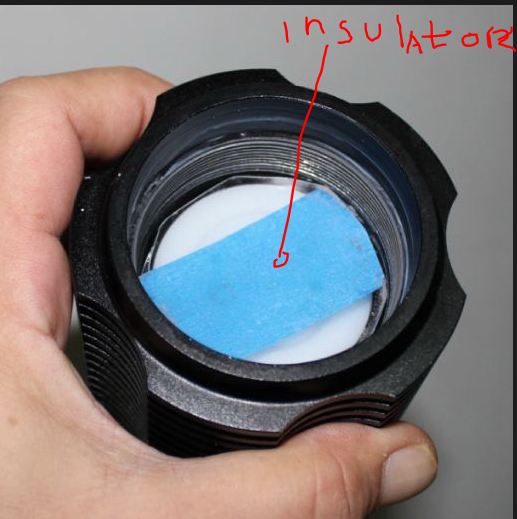

    The torch came with a simple aluminium carry box with low density foam shaped to the torch and the battery & charger, they lined the box with sort of cloth .....OK, at least inside of alu case is non conducting. The charger 220V ends are two metal prong, like any wall charger would be, if by accident during transport that prong touched the battery terminal...........BANG !!
    If you see closely, I made a clear plastic round disc with blue masking tape ( so that I can see the clear plastic...he he he ), I use that plastic as an insulator.
    So when I transport the light, the battery is inside the torch barrel, safer this way.
    To why I use plastic sheet while battery in torch barrel for storage/transport, is because due to the spin-to-ON design, it always have risk of accidental power ON during transport.
    What is keeping battery pack terminals from not touching light head terminals are :
    - The light head 2 negative terminals has harder springs and protrude higher than the single positive terminal.
    - In theory, accidental ON due to battery weight or inertia will be not possible ( as long as the springs are still good and torch does not hit acceleration of 10+ G .....ha ha ha ).
    - The two negative terminals springs, offer approx 2+ kg of resistance before it will sink down to same level as positive terminal and light will be ON.

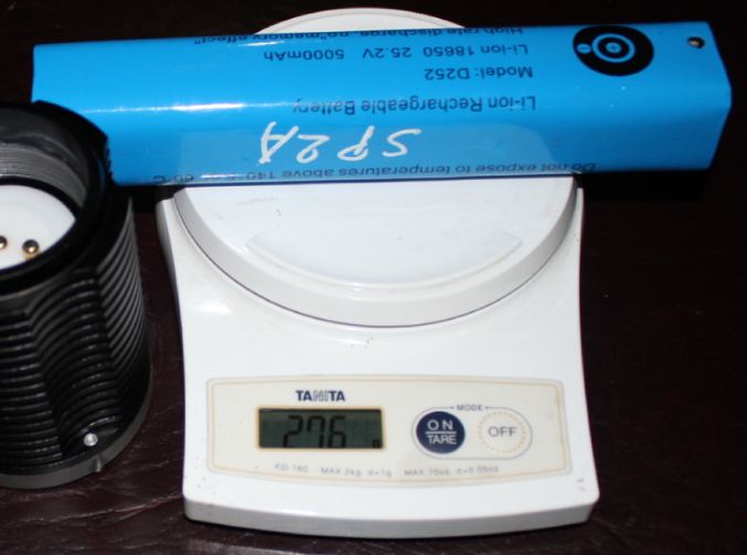

    - The battery pack weights 275 grams.
    I do not believe in springs for long term, I want real physical barrier.
    So the safety drill is, during storage or transport, install that plastic insulator sheet I made DIY and turn the barrel just enough to have a loose battery where it will not exert force to light head terminals, but two o-rings of the barrel must not be exposed and catch dirt.

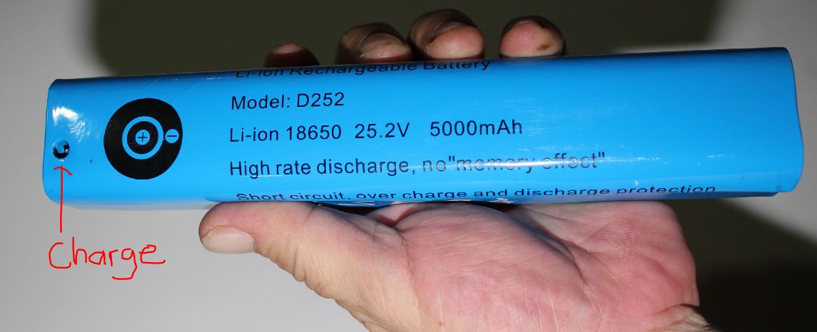

    THE BATTERY PACK
    It is a 12 x 18650 lit ion cell of 2500 mA
    The arrangement is 2 x 18650 as parallel SET
    This parallel SET is then wired in SERIES of 6.
    So total is 25.2 volt 5000 mA if battery is fully charged
    To parallel 2 of 18650 permanently is not so good a practice, even though each of the 18650 lit-ion is a safe battery type with protection and they are selected from similar batch.
    The battery pack terminals is actually a controller unit board.
    It does the following :
    - When charging, each 6 SET of the 2 x 18650 is isolated and charged as individual 3.7V 5000 mA lit ion battery
    - When powering the light head, 6 x 2 SET run in series and each SET is monitored for safety bla bla bla overheat bla bla bla
    I know they wanted to keep the barrel short, otherwise they can use 6 x 36250 of 5000mA lit-ion.....which will be most suitable for the controller board used.

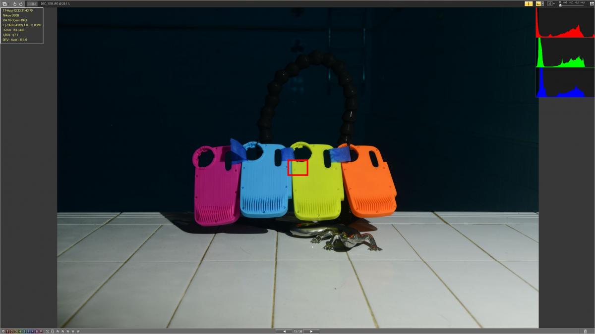

    This Archon color temp is like Inon 550W , nice and warm. See the test photo. That is single light and from approx 70cm, used to replace strobe.
