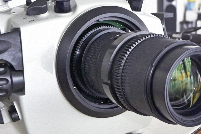

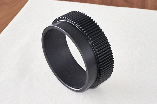

  4. Received new zoom gears for the 70-180 mm macro lens, they work with the lens and ND800 housing.....
    but are too large in diameter to allow the FP70180 port to attach to the housing sad.png
    The gear will be require machining to make the sleeve smaller in diameter &/or the port opening will need to be enlarged.

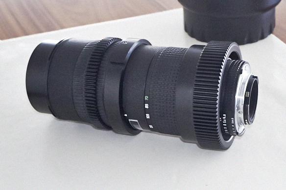

  5. I've used the 70-180 underwater for the last 12 years. First with the Nikon F5 and more recently with the D700. It is one of my two most used lenses. In both cases the housing was a Seacam and the Seacam housing and port system easily allows you to have gears on all three of the 70-180 rings - zoom, M-AF switch, and manual focus. A housing body with only one lens control makes using this lens a bit more difficult and requires two lens controls (M-AF and manual focus) on the port if you want the full capabilities of the lens. Otherwise a single control - zoom - is all you have.

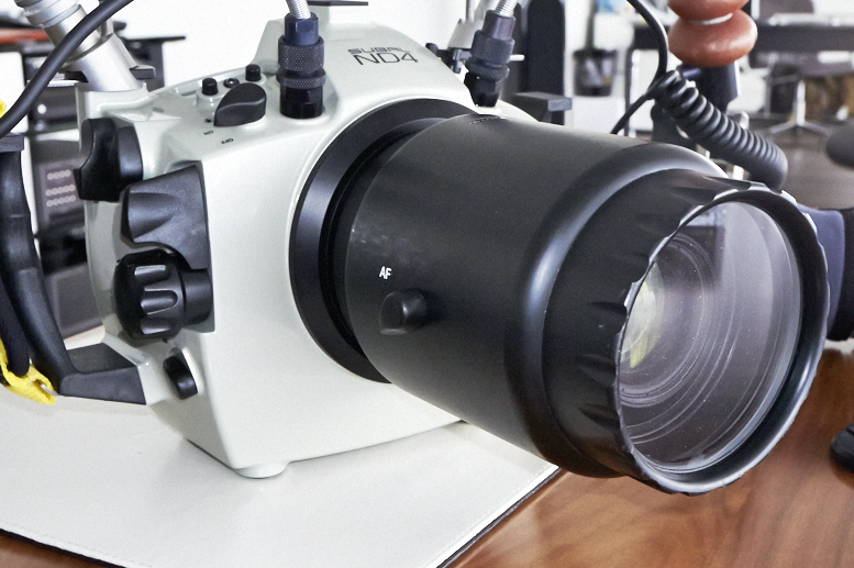

  6. I also got new zoom gears for the 70-180 and I am using this combo with Subal's FP70180 port without problems. (Zoom, M-AF-Switcfh and Manual focus). However, I have Port Type 4 (which has a larger diameter than type 3) on my new ND4 housing.

  8. yes I have mounted the port adapter on the FP70180 in order to fit on the type4 housing port.
    the zoom gear has the same external diameter (which is larger than the one I have used before --> for type 3 ports). I can make and post a picture tonight.

    It looks like we have the same gears, mine is also the same external diameter. I think this gear will work if the portion towards the front of the lens is machined down in diameter to match the old gear. My port is a type 3.

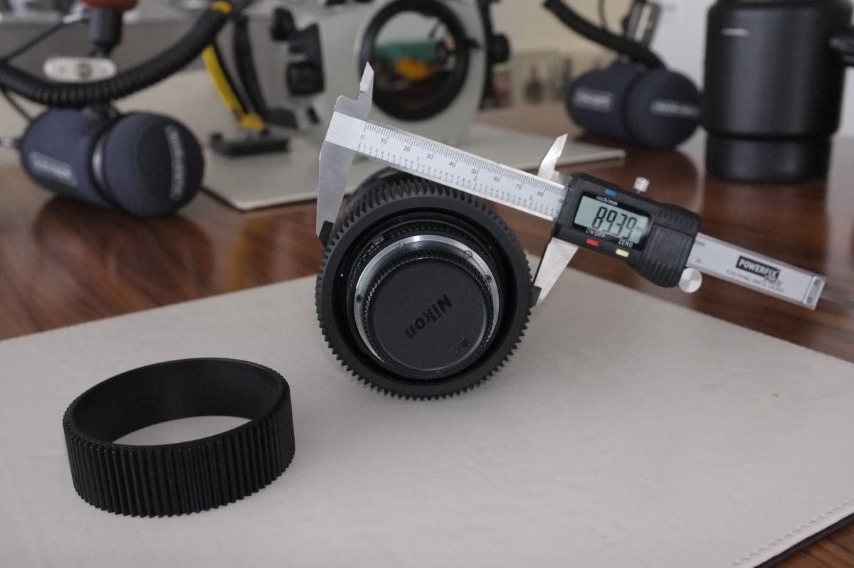

  13. Elmer,
    you are right! I checked again and found out that it does not fit into the port. When I got the new zoom ring I did try it only with the lens but not with attaching the port, how stupid! The zoom gear is little bit sticking out of the housing to get in conflict with the port (FP70180).
    I measured as follows:
    old zoom gear outside diameter is 82 mm
    port inside diameter is 84 mm
    new zoom gear outside diameter is 90 mm
    So, in conclusion, you are rigtht, the new zoom gear needs machining to the front side of the lens. I figured out approximately 15 mm from the front side (it is 35mm wide in total) and machined down to 82mm, e.g. 4mm on all sides.
    Now I have to find a workshop near me with a machining lathe
    Do you have a solution already?

  17. The new 70-180mm zoom gear is 35 mm long. If 25 mm is shaved off (to external diameter of 81.5 mm) in a lathe it will have enough clearance to allow a type 3 port to attach to the housing. This will leave 10 mm of exposed gear to provide gear engagement.
    Edited by eyu
  18. I found a workshop with lathes and let them shave off 15mm only. I measured the port FP70180 thickness, which is 10mm only. If 15 mm is not enough I still can shave it more in a second turn. The max amount is something like 25mm (measured from the font port opening to the zoom wheel. Expect some news in short time when I get it back fromn the workshop.
