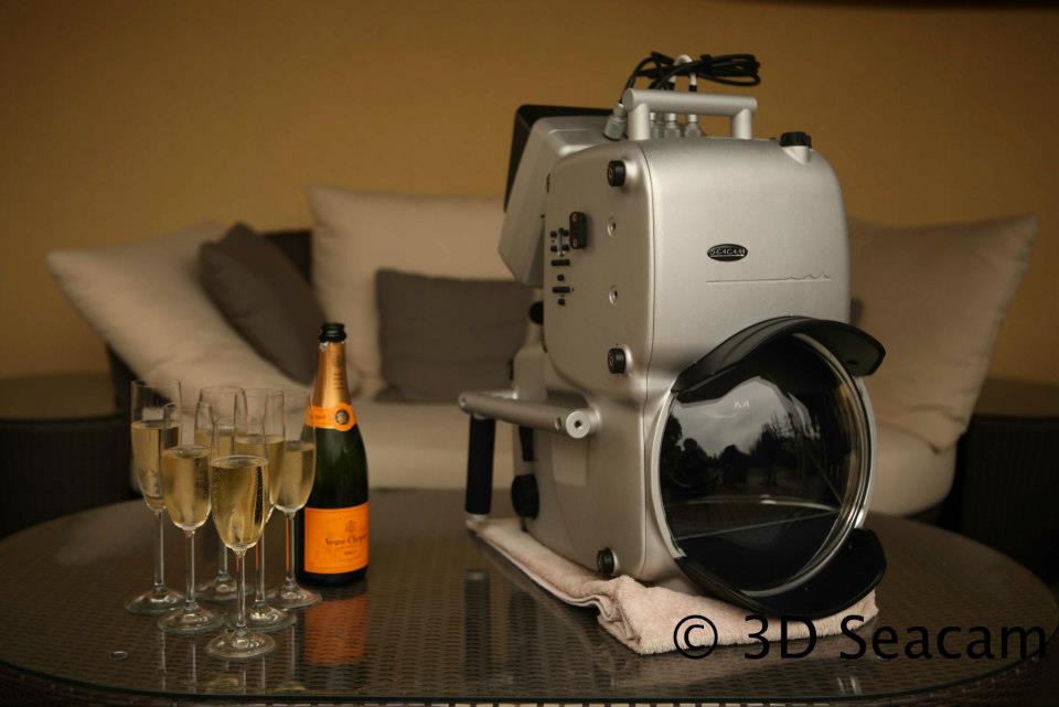

  1. Had to share this beauty!
    Deep wreck photographer Aldo Ferrucci (known for his use of the Nikon 14-24mm and therefore photos of amazing subjects with mushy corners - I wish he'd buy another lens!) shared a series of photos of a new Seacam 3D video system yesterday on Facebook.
    I've reposted one here:

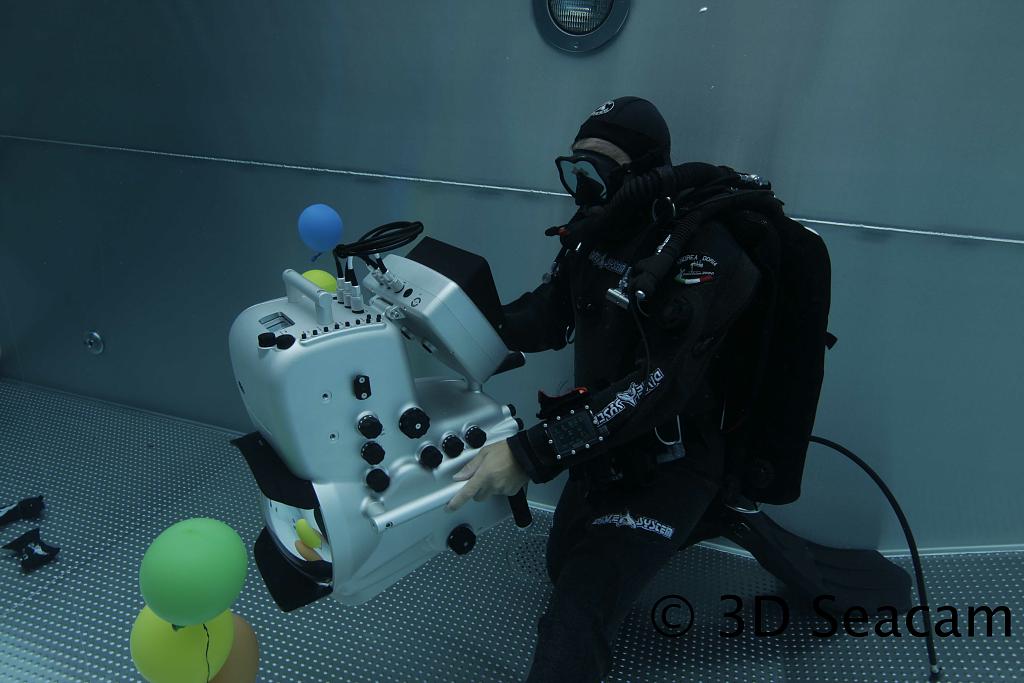

  2. ON RBW there are other photos but, again, you must be logged to see them.
    I'll post here just one pc showing how it's huge this housing:
    EDIT: the housing contains two C300.
    Edited by Davide DB
  3. Dome port for a beamsplitter 3D rig? Impossible. It would be interesting to find out how Harald managed the optical distortion between one C300 to another after setting the inter-axial distance. My guess is that it has a fixed inter-axial distance. May be all for close up wide angle. Love to see some 3D footage from this thing.

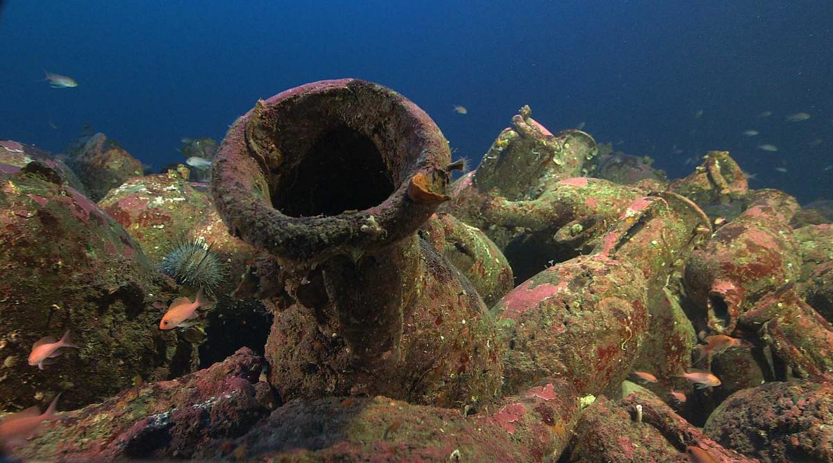

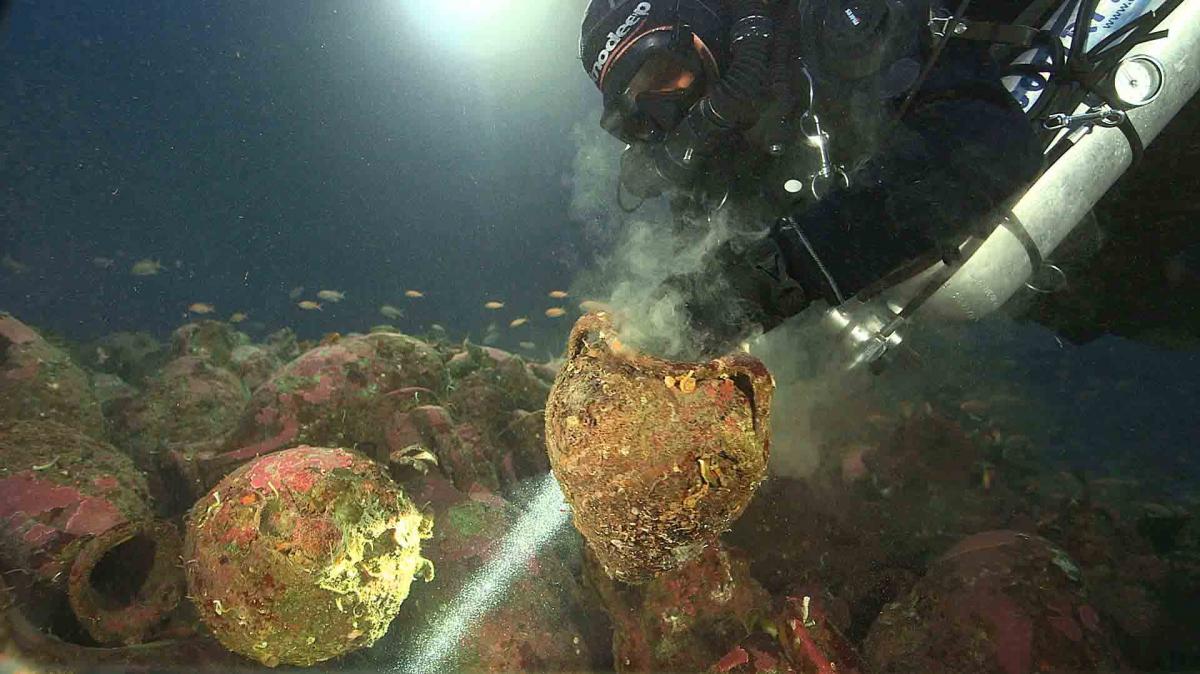

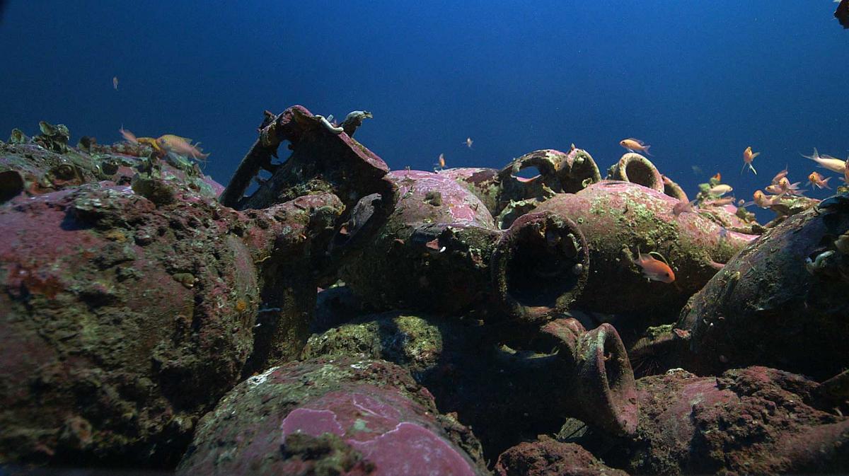

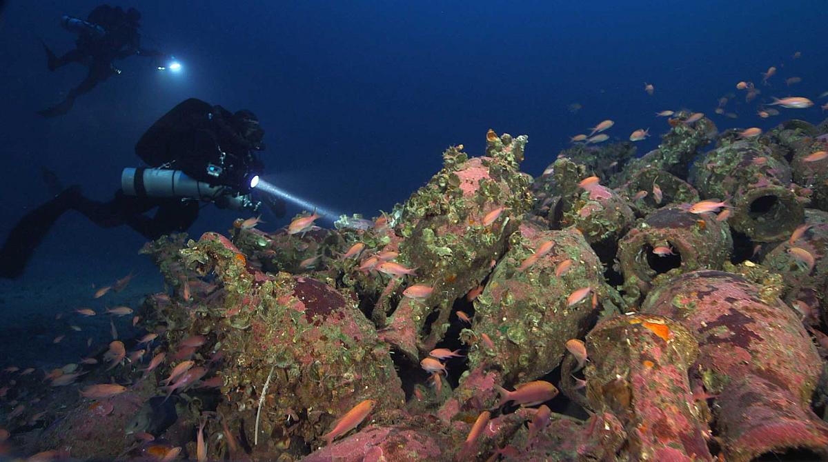

  9. good evening every body. Someone send me the topic about our new housing after Aldo posted it on I do not know which site. all the project came after an Idea I had working for a French production and following the teaching of Cyril Barbancon, a great expert in sterography and a very good DoP. He thought me all I know, and from my old knowledges about dome ports, I get the idea about how to built the right underwater rig. The most difficult part, was to convince Harald Hordosh from Seacam to jump in videography, after so many years of successful involvement in still photography. After I had explained him my theory about the dome in a 3D UW rig, he thought to call his father: this fellow was the real most important man in all the adventure. Harald father struggled months under our suggestions, but than, he came to a very precise drawing. From that point on, Harlad used all his skill and the once of his assistants to put ideas into a computer and built this wonderful machine. YEs, now we can change inter axe and convergece. We have access to all commands of the C300. We can use the 3D assist Panasonic monitor. We are not on the end of the project, yet, and the housing is not perfect as Harald wants, but I am sure we have a wonderful tool in the hands. For sure a 3D tool that we'll not stop from shooting documentaries in the usual way. Our second dive was on 100 + metres on a roman wreck. due to the winter light and to the depth, I was not able to use f stop more than 2,8 or 3,5. So, my depth of field was not perfect But I am sure these images can witness that the quality of the dome is not bad at all. Also considering that these images are just a print screen.
  10. Hi Roberto,
    Maybe you forgot to attach those images? :)
    Ciaoooo
  11. No, I was not able to attach them, i try again
  12. Thank you for the information, Roberto.
    You should be able to attach the photos to your post. You have to do it one photo at a time (choose the image, upload it, then add it to the post) then you can add another photo.
    Alex
  13. MAybe I have found the way to send some screen freeze
    ops, twice the same...
    Edited by Drew
  14. Beautifully shot images Roberto. Care to let us know which pair of lenses was used?
    cheers
    David
